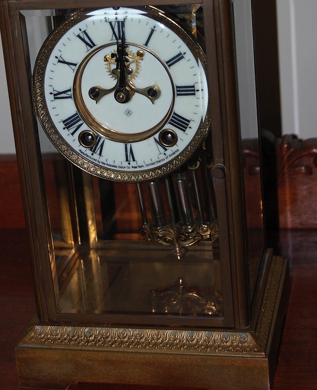

Found this on Christmas Eve. Listed incorrectly as an Astonia mantle clock
So here's my Christmas present to myself! According to what I've found it's branded "Cetus".

"Curly" SjolanderNice clock Dave, it has four of my favorite things in a clock
Crystal regulator
Open escapement
Mercury pendulum
It's an Ansonia
Curly
December 28, 2015, 21:26
Dave TurnerThanks guys, So far, that picture is about all I know about it. Should get it this week.
I was looking for two of the four, Curly. The open escapement and Ansonia. I didn't have either. This clock will be a learning experience. I don't have a clue about the mercury pendulum. Can't be real mercury, can it? I think they are definitely faux, but evidently at one time it was a practice. And the movement is a round design, also foreign to me.

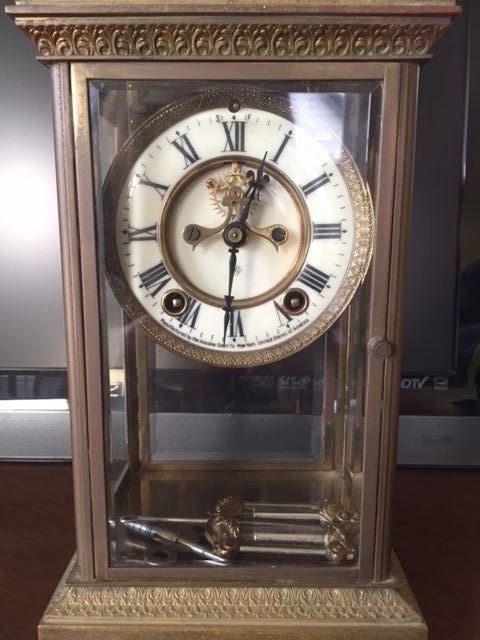

Dave TurnerGot the clock today! No bad surprises. One small chip on the backside bevelled glass. Set it on the shelf, hung the pendulum and away she went. Clock was listed as non-running. I suspect the pendulum is not real mercury based on your comments David. Thanks for the insight. So far it does not strike on the hour or half hour, but I haven't wound it at all. Thought I'd just let it settle in and see what happens out of the box before I do anything else.

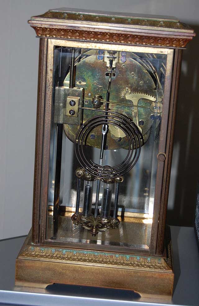

All I've done with my clock so far is to set it up and start it, and observe the operation. Haven't wound it yet, and it's ran for 4 days but losing time.
It will need service as it only strikes once on the hour and not at all on the half hour.
And I've noticed that the rack stays in the 1 o'clock position and fails to drop back toward the snail, after striking.
I'm going to have to revue what I thought I new about rack and snail sequence to resolve this problem!

David E. Booth, Jr.The most likely culprit in the striking department is that someone put oil on the rack pivot and it has oxidized and become gummy. It is a relatively easy chore to remove the rack and clean off the pivot, and clean out the tube. Because it does not have any loading on it, the rack does not have to be oiled: I always assemble them clean and dry.

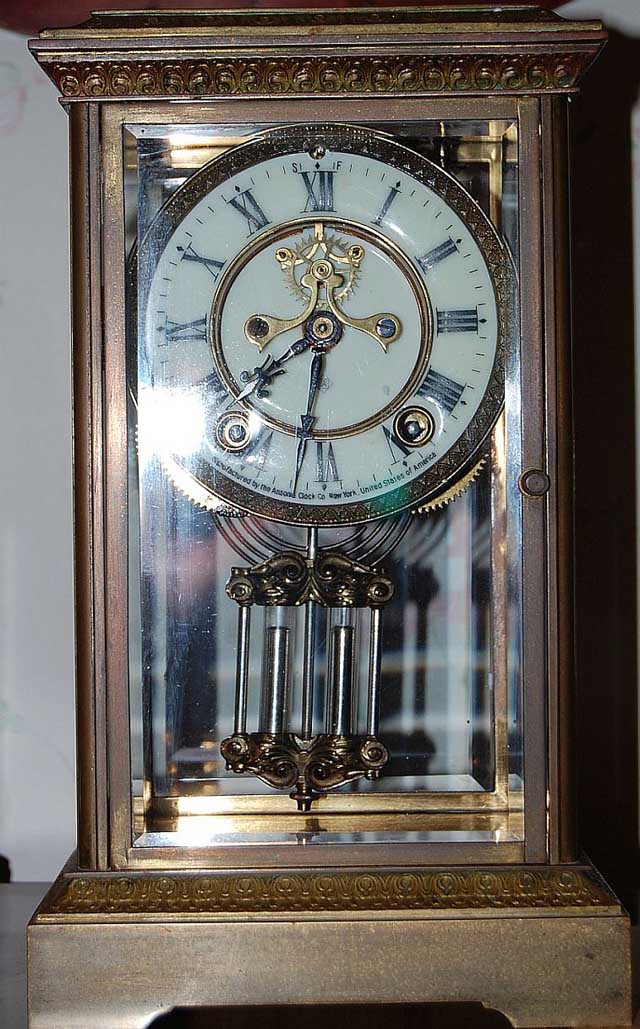

As to the slow running, I can see from the photo that the pendulum is run down nearly all the way on the rod. Were I you, I'd crank that sucker up a bit and see if it still runs. If it does, you can probably get it to keep time - there's lots of free room left in the flatted portion of the pendulum rod.
Most likely, that clock would benefit from a disassembly and cleaning. You will need a serious spring winder to deal with the springs in the barrels. One of those little hand-held winders can do it, but they take a lot of hand strength, and are dangerous, If a mainspring "gets Away" from you it can tear your hand or arm up pretty badly.

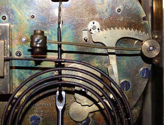

But during my observation period now, I see that the gathering pallet is not advancing enough to allow the rack to return to the snail. So, upon reassembly I'll have to make a slight adjustment. Thinking that 3 pin arbor will have to be rotated slight on the shaft.
You can see the second tooth on the rack against the pin at the bottom right.
Dave Turner
January 10, 2016, 23:01
David E. Booth, Jr.Looks like somebody got onto the clock who was a little heavy-handed. The gathering pallet looks pretty beat up, and I don't like the angle of the suspension spring, relative to the leader, and I don't like the way the pendulum rod in not hanging in a straight line with the leader. Whoever was in the clock last also didn't get the retaining wire properly formed around the end of the arbor for the strike hammer. All those things, when added together, tell me that an amateur has been messing about in this clock. Bet you the gathering pallet was on right, but when the amateur assembled it, he got the wheel a tooth or two off, and tried to fix it by changing the rotation of the gathering pallet. Then, in order to keep it from falling off the arbor, he had to beat it up.

Dave TurnerGot the Ansonia back in commission. Tore it down, cleaned and lubed it and spent about three days trying to get the strike timing right. Finally got it right by removing the gathering pallet and positioning it correctly. Should have done this from the start. Would have saved me a lot of time. But it was a nice learning experience.
