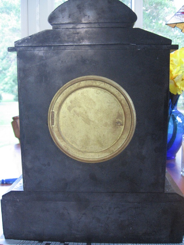

Here is the back.

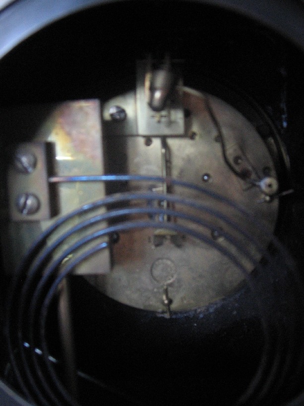

Here is the clockworks.

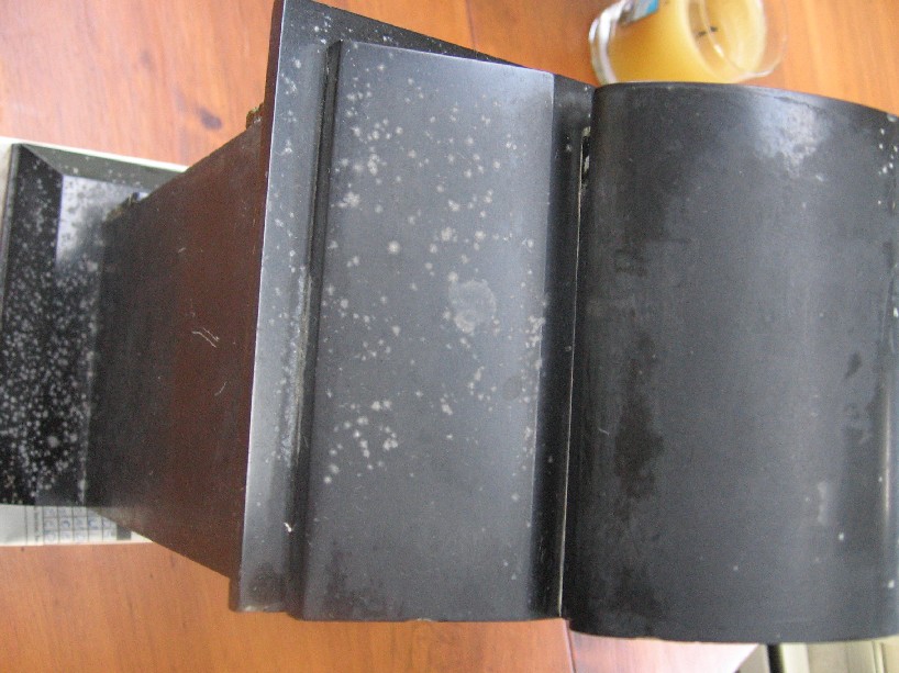

Here is the problem. I guess this must be fungus growing on the top.

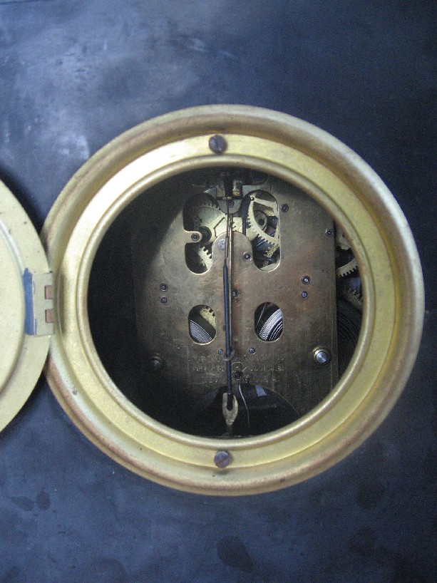

Here is the Ansonia clockworks.

The intrusion to the case surface is not as bad on this one as it is on the English clock.
I would rather not use something abrasive like steel wool if I can help it. Can anyone tell me what this is and how to get rid of it?

On cl;oser examination, the "English" clock is "made in France." It is stamped "Etienne Makant Brevet."

Most of these clocks in the UK have French movements in them!

Unfortunately, this sort of damage is Very common on this type case, and abrasives are the only way you'll totally get rid of it.
Usually caused by damp, water splashes and acids in the atmosphere from coal fires - these clocks were often placed on the mantlepiece directly over the fire!
The water/acid attacks on the slate have actually removed the colour from the slate and taken it back locally to its natural state!
The marks will also be small 'pits' in the polish, which you'll have to get to the bottom of before you can start getting the polish back.
Polishing them is also a long, tedious dirty job, but the results are worth it.
An alternative is to clean up the case with soap and water, dry it off thoroughly, then use a renovator liquid.
I still have a bottle of 'Black Slate Renovator' (surprise surprise!) by 'House of Harbru' which is good, but I think this company (in Rotherham UK) has gone out of business.
There are similar products on the market, so some dedicated 'Googling' or eBay searches for black slate renovators etc should bring up a few results.
I think one product is called 'Back to Black'.
Whatever you do Don't use a silicon based product for polishing them!
To do the best job, the cases really need to be dismantled - in some instances, this is quite easy, they fall apart eventually anyway as the cement fails!
Otherwise, strip very carefully!
If you don't dismantle the cases to actually polish them, you will inevitably have 'rubbing' lines along all the recessed edges which you can't otherwise get into!

To add a bit more, the damage to the front top edge of the base, could be disguised by forming a bevel all around the edge - this can be polished during the main casework!
Bevels and other ornate work were common on these, so if done carefully, no reason why it shouldn't appear original!
