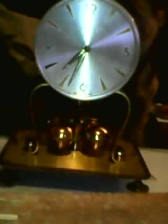

hi people, I have a Kern 400 day Bought as not running, put new suspension spring, goes ok all week but gains, fully retarded the weight adjust but no difference, could it be the wrong weight spring..?please, or what else would you suggest..

It could be the wrong spring. According to my 400 Day Clock reference: Kern Standard size used a .0036" (091MM) suspension spring.
Unless you have a miniature model. A good picture of the backside will help identify which model you have.
The more I look at this clock I tend to think you might have a miniature version. Need to see the back plate.

I believe it is miniature.. 7ins tall in the case.the spring is a 00.40 (102)
November 05, 2018, 15:31
Don Wilson
there is nothing on the back bar a circle with initials in..originally I put a 0033 ... but thought this may be why it was fast... too small a size,,, it is gaining around 6mins per hour with the pendulum screw full retard...

here is complet clock from rear.
initials look like KS on the back.

I have done some searching and it appears it may be a 'minuture'. with right side winder and ks initials .. the quoted spring for that is a 0.0023 would that make sense to you?.. ;-)

I think you are correct. According to the 'book' this is plate # 1349 which uses a 12F
.0023" spring. (as you said). 8 beats per minute.
http://stores.thehorolovarcomp...-suspension-springs/
The length of the spring is also critical, but you don't have much room for error. It needs to be long enough to fit into the bottom cup but short enough to be able to lock when moving or not in use. So you probably have the length about right by default. But I think you need to change the spring to the proper thickness.

hi dave yes it looks like I have gone the wrong way by putting the bigger size on.. I have a 23 on order, it currantly does 15 1/2 revolutions per min.. haha.
many thanks.. I shall come back once the new spring arrives and is fitted and running.. I have never done one of these type befor.. ;-)
