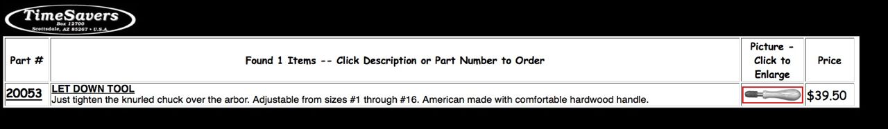

You will need to hold the springs with the clamps, but you should have a suitable let down tool, to control the speed of let down. I have read about people using a broom handle that was slotted to fit over the winding key that came with clock and I guess it will work. But here are a couple suggestions on this page from Timesavers. This is my favorite supplier for any clock repair stuff. This page includes a set of clamps, and a spring winder that are reasonable. Also I found from Timesavers a neat tool for letting down springs also. You will be able to wind up the springs after cleaning with this tool also. Also its a pretty good idea to use leather gloves and safety glasses for "just in case" things don't go as planned.
