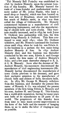

Tom BrownHere is a little more on both men;
Andrew Meneely was born at West Troy (Gibbonsville) New York in 1802 and died in 1851. On January 1, 1836 Meneely took Jonas Volkat Oothout as a partner. For a few years the business was carried on under the firm name of Meneely & Oothout. Mr. Oothout retired in 1838 and Andrew Meneely continued the business as formerly. Jonas Oothout was born in West Troy, New York in 1814 and died there in 1860.
August 13, 2009, 22:32
Tom BrownNot sure if this will be readable.
It is from "Bi-centennial History of Albany Vol. 2"

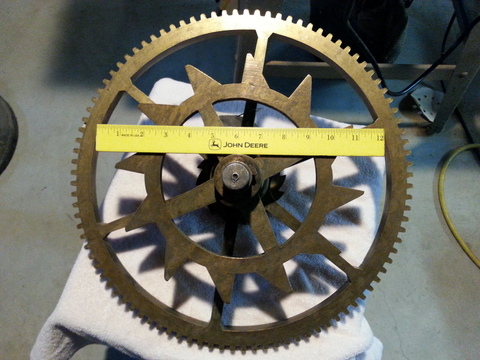

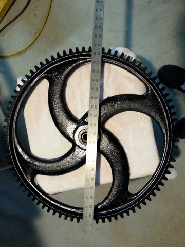

Roger J. NolfeSo as not to hijack
Kevin Hoffman's thread, I'll post progress pictures here per Dave Turner's request. These parts are massive and heavy.
April 06, 2017, 15:41
Roger J. Nolfe2.

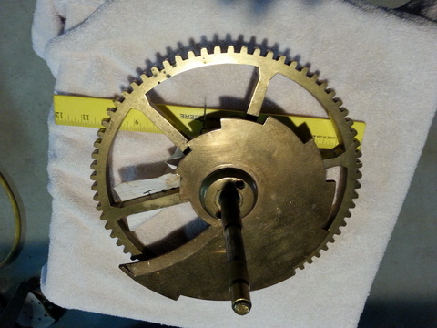

April 06, 2017, 15:42
Roger J. Nolfe3. Escape wheel showing pins.

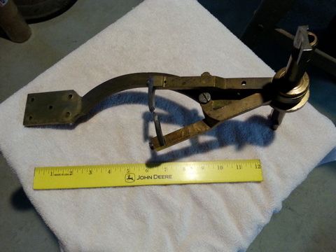

Roger J. Nolfe4. Pallets. Pendulum attaches to holes at left.

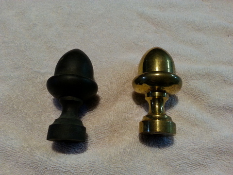

April 06, 2017, 15:43
Roger J. Nolfe5. Decorative acorns total 4
