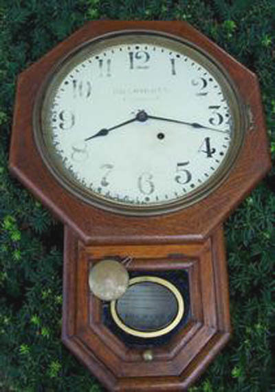

I just purchased this clock and was wondering if anyone could lead me to a reputable restorer for the clock face and maybe the glass in front of the pendulum. It has a Seth Thomas 8 day movement in it that may need a cleaning as well. I plan on refinishing the case as I am an avid woodworker.
Steve

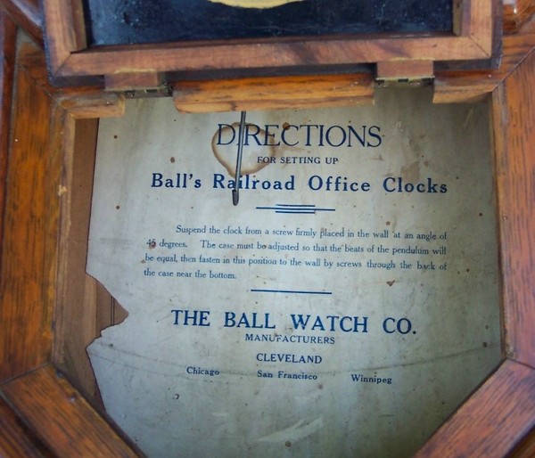

September 02, 2008, 12:06
Steve MiddlesworthAlso the paperwork on the inside.....

Looks like someone became overly-aggressive in their cleaning and did far more harm than good to your dial. You have what I would take to be an original Ball Watch Company Clock deserving of proper restoration.
The name that comes to mind for your dial work is Martha Smallwood, her contact information is...

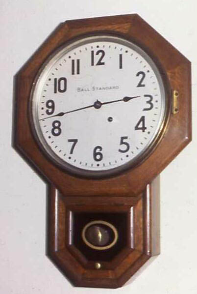

You may want to look at our "Webb C. Ball Railroad Standard Watches and Clocks" presentation, slide number 55 shows a nearly identical clock to yours. This IHC185 presentation is now on also YouTube at this link...
CLICK TO WATCH: "Webb C. Ball Railroad Standard Watches and Clocks" on YouTube!
Jim Hernick describes the clock that is similar to yours as being a spring-wound Ball-Seth Thomas from about 1920 measuring 23 inches tall having a 12" dial.
Hope this is of help my friend,
Similar clock in the Ball Show...September 03, 2008, 18:06
Steve MiddlesworthLindell,
That looks very much like my clock except for a little bit different on the dial face. Other than that though it looks to be the same thing. Thank you for the contacts, I will get in touch with them.

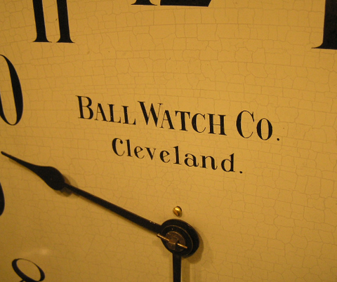

Steve MiddlesworthHere is a close up of the dial. Martha at The Dial House put a crazed (I think that is the word I'm looking for) finish on it and at first I thought some extreme temperature change reacted with it but it is smooth and just part of the finish. For an 80 or 90 year old clock I think it is a very natural touch. They even replaced the little ferrule where the key goes through to wind the clock as well as polished up the dial ring and gave it a coat of shellac.
Steve

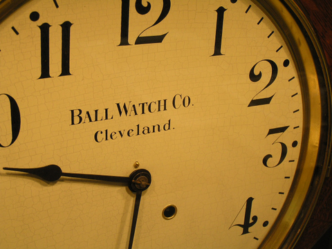

October 26, 2008, 10:06
Steve MiddlesworthHere is a closer look at the finish on the dial....

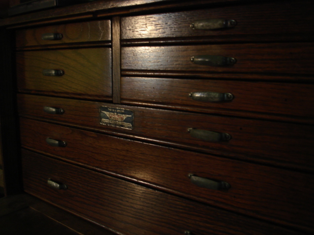

Lorne WasylishenVery nice job Steve! what did you have to do to the case?
When I got this tool chest it was very dirty so I cleaned it rubbing fervently with paint thinner and an old T shirt assuming it would need a lacquer over coat.
It buffed out nicely without needing anything else. I left the flash off to show the soft sheen.
