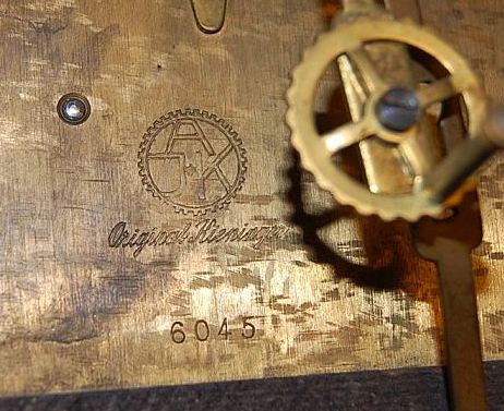

Here's a picture of my German Kieninger, emphasizing the logo, but shows the mechanism. What you describe sounds like something like this one.
Dave Turner
