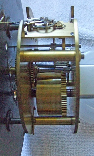

Ken KnightAnd finally, a picture of the complete movement.

Eddie G. HinesGREETINGS KEN, IT LOOKS LIKE THE PLATFORM IS NOT ORIGINAL, IT SEEMS NEWER THAN THAN THE OTHER PARTS OF THE CLOCK. THAT IS WHY THE BALANCE WHEEL LOOKS OUT OF PLACE. EDDIE

Ken KnightEddie,
I'll bet your right.  I noticed someone has soldered an extension to the adjustment bar.  That is tacky. I'll need to see if I can find a better replacement.

www.bhi.co.ukInteresting clock Ken, Astral were big clock manufacturers at one time, and also produced movements for mantle clocks of the 'Napoleon Hat' variety.
The platform as Eddie states, is way too late for your clock, it has variable beat adjustment as well as regulation.
If you look at the stud, this is on a moveable plate, which shifts the whole hairpring and balance orientation relative to the lever - it's a lot easier method than tweaking the harspring collet round on the staff!
Shame you didn't holler for a platform a few months back, I shipped out about a dozen or more Swiss lever types that would have been correct for this movement.
You will certainly find them on eBay, as they're regularly listed, but before you bid on any, you need the plate dimensions, the pinion leaf count, and depth of the pinion, as all these are widely varied and easy to buy something totally unuseable.
The extended reg lever is something you may have to make anyway, as it appears to be unique to that clock, generally they're all short(ish).

Ken , you may want to check the mainspring barrel and centre wheel on your clock, taking another look at the photo, it appears the centre wheel pinion is only halfway onto the barrel teeth, not good!
The other end of the barrel also appears very close to the centre wheel, and looks like the barrel has been shifted across on the arbor for some reason - could be badly worn inner hub faces?

Ken KnightJohn,
Thanks for the heads up. I need to open this clock anyway to measure the platform.  Oh well, that is what happens you buy a item and not look inside the box. :-)

Ken KnightIf you look again at the picture, you will see that the center wheel is connected in the back to the third wheel, which inturn is connected to the barrel. However it does give the illusion that the center wheel is connected directly to the barrel.
