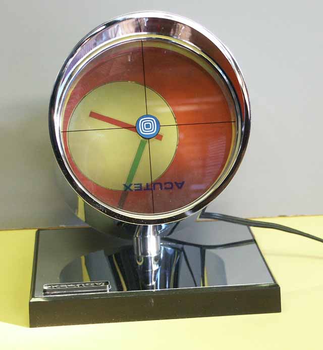

Acutex clock. It is 120 Volt, AC current. About 8 inches wide and a foot long. Because all of the lettering is upside down when the clock is set on a horizontal surface, I assume it once had a bracket that suspended it from a ceiling.

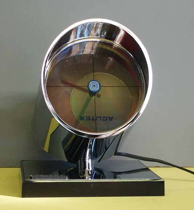

The disc in front of the hands revolves. It is backlit and changes colors as the disc revolves.

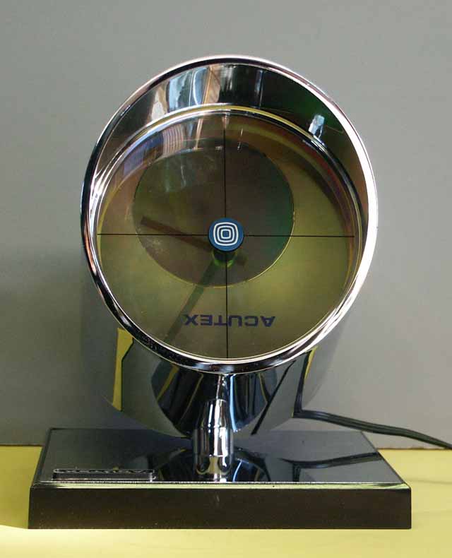

Another color scheme
December 11, 2005, 01:08
Dick Feldman
This goes on and on...and on. I think you get the idea.

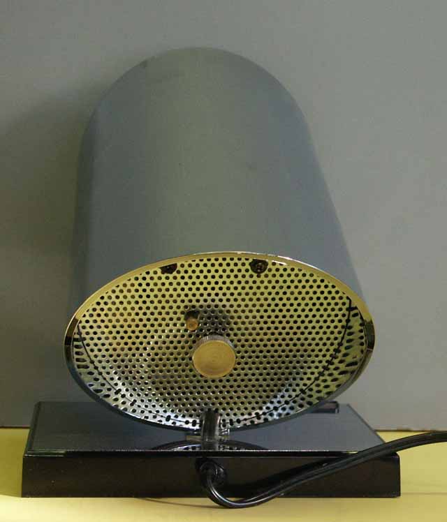

The rear of the clock. The big knob sets the clock and the small one changes the color scheme.

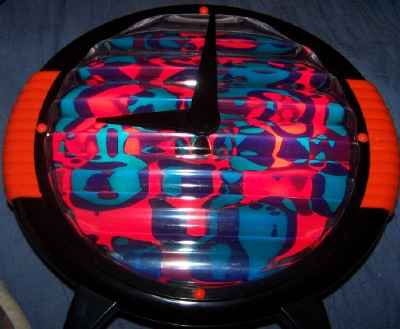

That looks neat to me! It looks like the Timex colorfix wrist watches, and a Lava lamp clock they made in the 1980s that used plastic discs with irregular shapes to mimic the liquid in Lava Lamps. When the discs turn in opposite direstions, it looks like flowing color changing liquid (but it is plastic).
