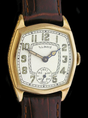

I'm glad you discovered Bryan G.'s website; he is a great source for vintage art deco era wristwatches. You should also invest in Fred Friedberg's Illinois book, which is amazing in its detail.
Here's my own Blackstone, by the way...
