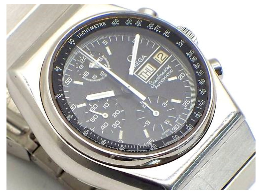

I grew tired of trying to get my Automatic Omega to run after being fully unwound. Would it be harmful to leave the stem pulled out to the set position which stops the watch from ticking and storing it that way? Thanks for looking and any answers or thoughts...

Tom Bruntontruly a beauty watch Bill

Bill GoffThank you Lindell and Tom. I would not want to do harm to my old friend. It still keeps great time.
