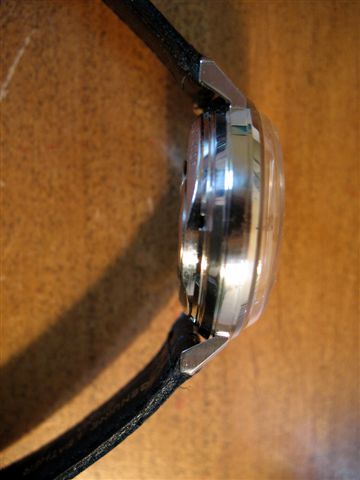

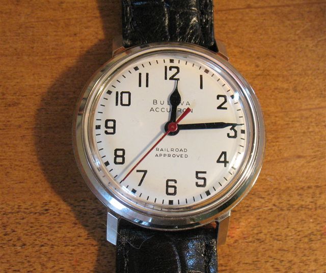

Bob KapinosI finally got a nice working RR Accutron! Lindell fixed me up with a beautiful watch. The watch is keeping great time and looks almost new. My photo taking abilities do not do this watch justice, but I wanted to show it anyway.
Bob

Mark CrossWOW, Bob! That one IS a dead ringer to mine...right down to the strap!
I need to go home and make sure mine is hanging on it's hook!!
NICE!!!!
HIGH regard! Mark

The hands did not show up well in my photo. They are a real pretty blue when in the light. They really shine.
