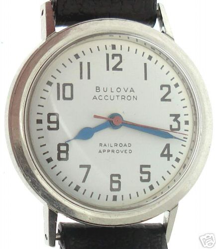

I take several motorcycle trips every year. These are the only times my pocket watches stay at home. I've been looking for a wristwatch with a little soul to wear on these trips. Last night I purchased a Bulova Accutron to serve this purpose. My local watchmaker told me that these watches were fairly durable and water resistant. He also mentioned that these watches may keep me up at night with their humming sound. lol
I hope I have purchased a correct accutron and not a madeup watch. Your opinions would be appreciated. With my extremely limited knowledge of wristwatches anything is possible.

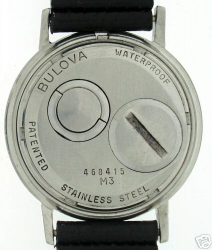

Bob Kapinosback

Mark CrossLooks just like my Accutron 214. There are a LOT of Accutron fans here, and I'm sure will chime in.
Of the water resistant claim, it's true, but only if the battery gasket is new. They're usually replaced when the watch is serviced, so I'd check with your watch seller and find out if that's been done recently.
On that note, how long ago WAS the watch serviced? They're great timepieces, and accurate as all get out.....but slowly becoming collectors items in their own right due to the old technology and rapidly disappearing parts supply. Most repairmen are cannibalizing old movements to keep our 214's going.
Like I said, I'm sure others will chime in, but to my eye, it appears to be all correct. It matches my watch point for point. I believe the date on yours is 1973, based on the number on the back of the case. Oh, you won't hear the humming. I used to hear it all the time, but as you get older (and you being an old motorcyclist), you probably won't hear that frequency as well now.
Regards! Mark

Looks like a nice one Bob!
That is a 214 which was the original Bulova Accutron that came out in 1960 and was available in the Railroad Approved configuration for many years. Accutrons are tough, reliable watches that I have worn and collected for nearly forty years. Your watch is in great condition cosmetically and should provide a great deal of enjoyment. They are water resistant but I would avoid immersing an Accutron or for that matter any watch without a screw down crown.
When it comes to changing the energy cell, use extreme caution. Most battery powered watches are designed to have the plus side out, whereas Accutron tuning fork watches use the plus side facing inward. Failing to observe that is the fatal error that has caused the untimely and unnecessary demise of many Accutrons over the years. Here is additional information including an Accutron 214 Railroad Approved Instruction Booklet...
ACCUTRON, BASIC TOOLS AND IMPORTANT INFORMATION
Carefully follow the instructions in that booklet for best results.
I must correct Mark and agree with the seller that your early watch with the "M3" date code translates to 1963 not 1973 production. With Bulova an "L" was used in the 1950s then "M" for the 1960s and an "N" for the 1970s with the number following being the last digit of the year. It's a simple code and the 1963 production was shown as "M3" on your case-back.

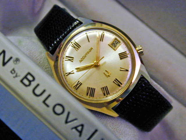

Enjoy your Accutron, with responsible care it will be with us for many years to come. The 218 you see in the image below is of a later design that is slimmer and sets using a conventional crown located at the 4:00 position. That watch is very special to me, it is the one I bought on time payments back in 1969 and I wore it daily for nearly twenty years.
Bulova Accutrons are stylish and worthwhile timekeepers...

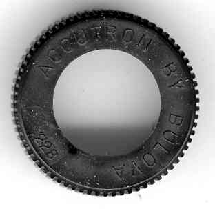

Bob KapinosI would like to purchase the opener but I'm not sure if it correct or not. It does have a number "228" on it and the watch I purchased is a model 214. Would you accutron experts know if it will work on my watch?

That kind of tool is designed to remove the entire back, usually in changing the energy cell on a later 218 Accutron, although the 228 number may mean it is intended for a different later model. They are most useful on a gold cased watch in order to avoid marring the finish.
