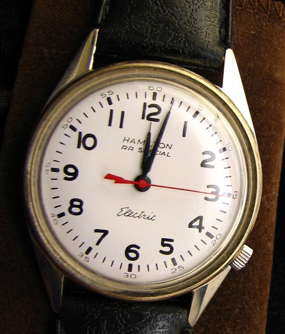

Just picked up this two-tone cased Hamilton Grade 505 marked
Hamilton RR Special and
Electric on the dial. It has a cool zig-zag electric red second hand.
Anyone know what kind of cell these require? Can I use a modern battery? If so, which size is appropriate?

Chris AbellJohn, a 387 and +ve up if I remember

Tom DunnJohn; My watchmaker just got done with one I had
and said the newer batteries won't make proper contact on these. They used to take a 302, the bottom (-) on the newer ones is stepped and these require a flat bottom. He had to end up using a 391 and modifing the strap cause they were a little shorter.
At least that's what he told me. See what yours does, and let me know. I've got a Van Horn and a pacer needing batts as well.
