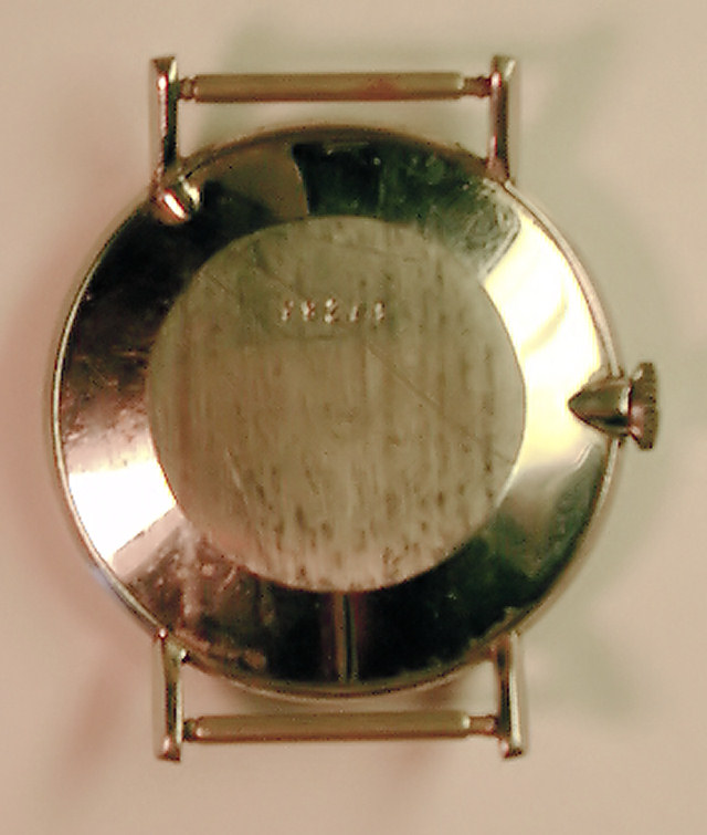

July 22, 2006, 12:04
John WoolseyCase Back.

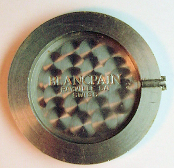

July 22, 2006, 12:05
John WoolseyCase back markings

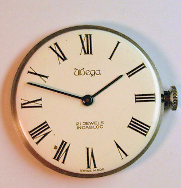

July 22, 2006, 12:07
John WoolseyThe dial appears to be some sort of enamel over a thin plate, there is a small chip out of it, looks quite brittle.

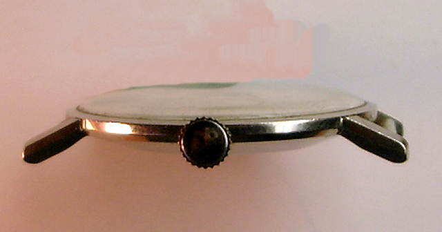

July 22, 2006, 12:11
John WoolseyCase Body - apologies for the none too good clonebrushing, I stood the watch on some Rodico and tried to paint it out as best I could.

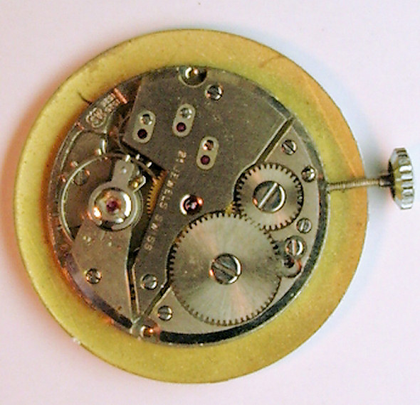

July 22, 2006, 12:14
John WoolseyThe movement has no manufacturers marks anywhere except for the ebauches AS.

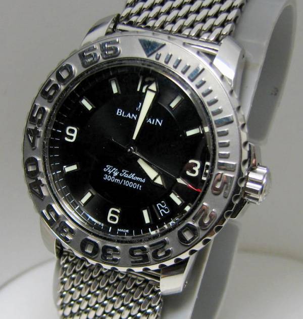

July 22, 2006, 17:11
Dave FreemanJohn,
I'm sorry to disappoint you, but I really don't believe the watch you show is a Blancpain. Shown below is a picture of the Blancpain 50 Fathoms that I own. Although your watch is clearly of a different style and model to mine, I think you can see from the quality of the workmanship there's quite difference.
Blancpain has always been, and still is a marquee brand.
Dave Freeman
