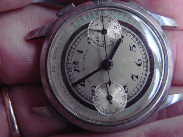

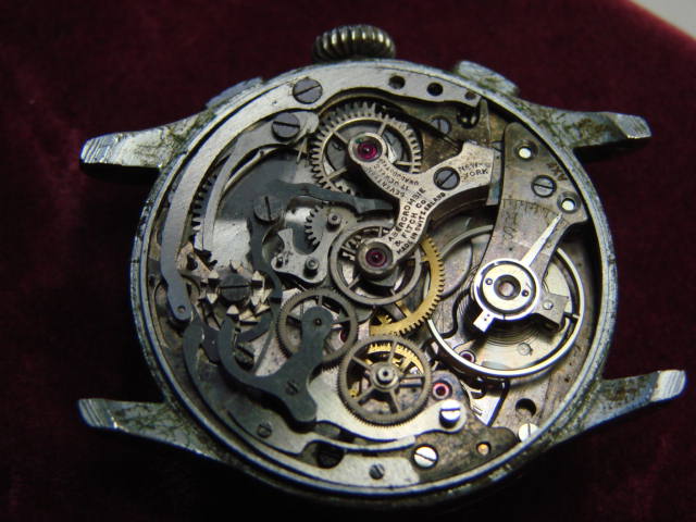

just a little cuty I picked up a while back in a box of watches and stuff,runs great,start stop button works fine, re-set button non functional, Anyone have an idea of the maker?
August 22, 2010, 00:29
Michael KosinenkoThat is a 17 jewel Angelus 210. It is missing the heart piece lever that resets the hands.

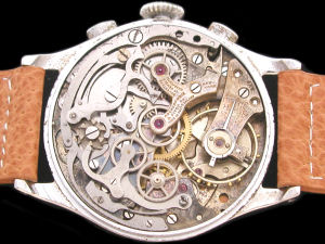

Tom BruntonHI MKE; IS THIS THE SAME AS MY MOVEMENT?
http://www.farfo.com/images/ab...angelus_movement.jpgAugust 22, 2010, 09:16
Michael KosinenkoYes, that sure looks like the same one.
Mike
