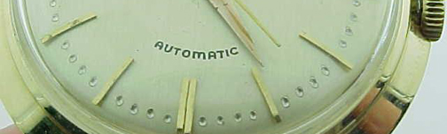

One of the easiest dials to detect refinished are those with a pearled track - this is the circle of 60 tiny, usually domed, often gold color, convex dots marking the seconds. These sit on an invisible circle at the outside edge of the dial, and in an original dial are extremely precisely positioned.
Now when this style of dial is refinished the refinishers usually overspray the entire dial with the relevant color enamel, which results in the "pearls" also being oversprayed. The dial pearls are then cleaned out of enamel using a tiny drill, resulting in 60 now pits, concave. This is rarely done neatly enough and results in some pearls out of line from the correct circle.
These out of line, concave, pearls are easily spotted.
refinished pearls
