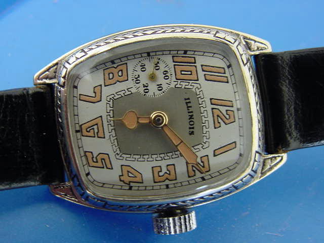

Samie L. SmithHere is a Dail and hands on a Illinois Marquis refinsed by International i think they did a great job..
here is a picture i think it looks great..

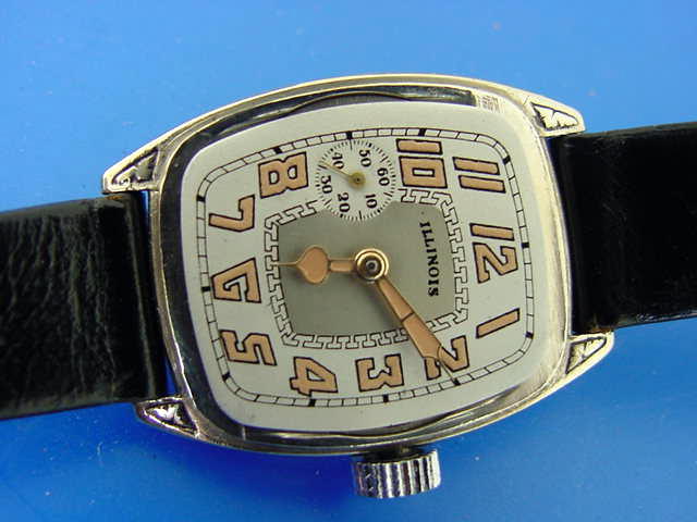

Samie L. Smithwith the bezel off

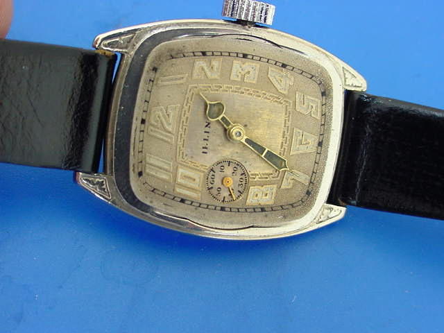

Samie L. Smithhere is a shot of the dial before it was refinshed.

Joseph W. RobinsonHi Samie,
Great looking watch and beautiful dial! Are the hands NOS replacements or did you work some kind of magic to the originals?
Joe
August 20, 2007, 17:46
Samie L. SmithHelo Joe is it still hot in tenn.
The hands were also done by International.

Rick VessSamie,
Nice MArquis! Did you re-fill in the black enamel of the lugs and bezel with the old "brush on, wipe off" method? Looks great!!
Rick
August 21, 2007, 16:28
Samie L. SmithHello Rick
yes that,s what i did ,i have in the past used the black enemal from casker,s and heat to set it works good but a little tricky to do...I plan on listing this one on ebay later today frist one i have had without nay brass showing...
How do you raplace the black enemal.
August 22, 2007, 16:02
Rick VessBryan gave me this tip on how to fill-in the enamel a while back, and it works well. You just brush-on black enamel paint (Testers model enamel or similar works fine), wait a few minutes (not too long!), and wipe off the enamel with a papertowel or piece of thin fabric. Be careful not to wipe the enamel out of the engraved areas. I have also done this after intentionally thinning the paint a little with thinner, and this seems to reduce the risk of waiting too long and having the paint dried on the raised portion you are trying to wipe off.
I presume you are doing something similar?
Rick
August 22, 2007, 20:35
Samie L. SmithRick yes that is how i fill in the enemal i use a black enemal paint my wife uses on the jewelery she makes it,s a oil based paint.
