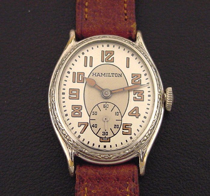

Adam M. DubinHere's my Oval that has been recently refinished with International's "aged luminous" [photo courtesy of Bryan].

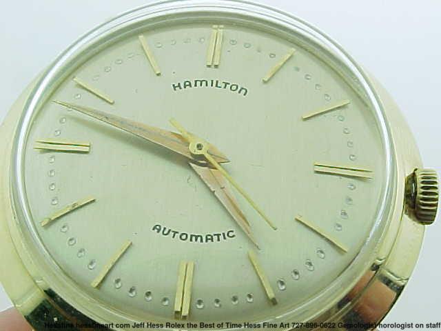

Dan MitchellRob - welcome, and I have a question for you.
The most difficult style of wristwatch dial for anyone to correctly refinish appears to be those with a "pearled" minute track -- each minute position marked by a tiny convex gold dot.
The "pearls" always seem to end up as unpainted concave depressions, out of the exact line - why ?
See horror below (not one of yours !) ---
May 05, 2007, 12:12
Robert E. MillerDan-- In reply to your question you bring up a great example of how a dial is refinished differently than how it was manufactured When a dial is made first the feet are welded on to a dial blank. This can be done before or after the dial is trimmed to the final size. Once the feet are in place they are use to properly align the dial in various jigs used in other steps of the manufactureing process. A die will be used to curve the dial blank then the dial will be sent to the pearling machine. Imagine a small drill press whoes table is really an index head. Interchangeable jigs for different dials etc. Once the dial is in place perfectly centered and adjusted, the drill head is then adjusted as to diameter and aproach angel. and a pearling bit of the proper size is installed. Once everything is in place a dial in inserted in the jig, the drill head is depressed and one mark is made. The index head is rotated one click and another is made untill the dial is finished. If your doing a thousand of them its easy, if your doing one thats another story. In your case someone just drilled little indentations around the dial. We do not have the jigs that will allow us to set up our machine easily for just one dial. Although we do have the pearling machine and the pearling drills most are getting dull and we have not found a supplier for new ones. The swiss have become alost impossible to deal with, and most dial refinishers are not going to invest thousands of dollars in tooling for this one operation. We only have this machine because we used to manufacture dials and many had this type of dial. probably more info than you needed but its an answer.
