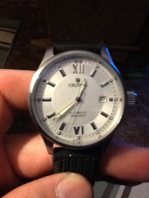

Unknown Croton model with Miyota automatic movement
I just bought a Croton watch, model unknown, movement as far as I can tell is a Japanese Miyota 8215, 21 jewel, unadjusted automatic. Anybody familiar with Miyota and this model movement?

Thanks for the reply,It's in a display style case, screw down crown, with a silicon strap and deployment clasp, lately it has begun to lose a minute or so daily, was very good timekeeper. Appeared new or very near so when I got it. I've been wearing almost daily and I've been catching up on some home repairs, maybe I harmed it. Maybe just getting broke in and needs an adjustment to the regulator. Any thoughts?
