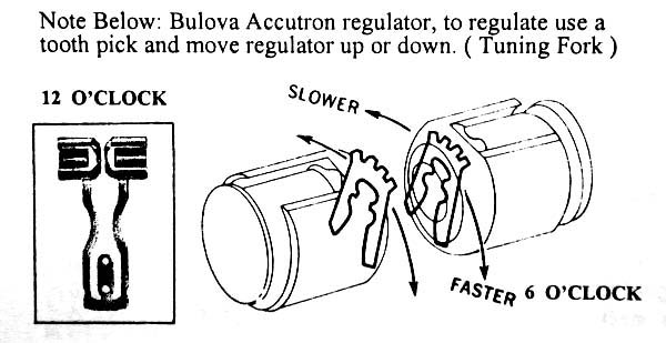

I've worn Accutrons daily for thirty-plus years and found that unless they are erratic which yours is not they can be adjusted to near perfection. Your 214 is within the factory specs "a minute a month" and I'll bet the 218 will soon be again as well. It probably got slammed hard in shipment.
The "phasing" Steve spoke of is beyond my capabilities but regulating an Accutron movement is a fairly simple adjustment. Regulation involves a special Accutron-related tool but a toothpick will do if you are very, very careful. Do an "Accutron" search on IHC185 for further worthwhile information. Lots of good Accutron info is located on the internet and a "Google-Search" of "Accutron" would easily yield additional results.
The drawing below is from
"The Complete Guide to Watches" and has the basic information you need. Proceed with caution and move both sides toward you an equal amount. A lot of wierd things happen in shipping so lightly "puff" the fork area to be sure there is no dust or debris in the way.
Steve knows far more about these than I do and any further recommendation he makes should take precedence over my suggestions.

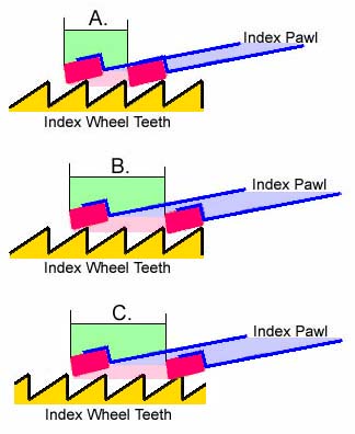

The information provided above by Lindell accurately pertains to "regulating" an Accutron, not "phasing," which is a different thing. The total range of adjustment through the regulator system is plus or minus about 30 seconds per day, which is not sufficient to rectify a 1 - 2 minute per day problem.
Basically, the way an Accutron works is that the tuning fork is magnetically "pinged" into oscillation by the electronic circuit and coils. The frequency of the "ping" isn't critical, so long as the fork continues to oscillate. Think of it like ringing a bell; it doesn't matter if you ring a bell fast, or slow, the tone produced by the bell will remain unchanged because the bell is tuned that way. The same is true of the tuning fork in an Accutron; regardless if it's pinged fast or slow, the oscillation frequency of the fork will remain constant.
In order to "transfer" the mechanical motion of the vibrating fork into a force with which to drive the movement, the tuning fork has a tiny leaf spring mounted on one side. That spring is called a "pawl," and its unattached end is fitted with a jewel (much like a pallet stone), which is supposed to engage an "index wheel" with 300 "saw-tooth" shaped teeth around the perimeter. When the tuning fork oscillates away from the index wheel, the pawl "ratchets" backward over two index wheel teeth, and when the fork oscillates the other way, the jewel on the tip of the pawl engages the teeth on the index wheel, and advances the wheel forward. For every complete oscillation of the tuning fork (from one extreme of motion to the other and back again), the tuning fork is supposed to advance exactly two index wheel teeth, no more and no less.
Now, here's where the fly enters the ointment: The original batteries for Accutrons were mercury cells, which produced 1.35 volts. Unfortunately, those were banned by the EPA, and only silver oxide replacement cells, which produce 1.55 volts, are now available. The extra voltage applied to the coils causes the tuning fork motion to be greater than it would be with 1.35 volts, and unless the index system is adjusted perfectly, the extra motion can occasionally cause three teeth to be advanced in an oscillation, instead of the usual two. Obviously, that will make the watch produce a gaining rate, the amount of which is directly related to the degree of phase error.
It's possible to phase most Accutrons to operate correctly with 1.55 volt batteries, but the "pawls" have to be adjusted almost perfectly. As noted above, the "index pawl" is attached to the tuning fork, but another pawl (called the "ratchet pawl") is attached to a stationary post, in order to prevent the index wheel from rotating backwards.
In the following sketches, the index pawls and a section of the index wheels from a typical Accutron movement are represented. In figure "A," the "normal" amplitude of tuning fork oscillations produced by a 1.35 volt battery is illustrated. Note that over the entire range of amplitude, only two index wheel teeth are covered.
In figure "B," the increased amplitude resulting from a 1.55+ volt battery is represented. Amplitude of that amount allows three index wheel teeth to be covered by the range of motion, and depending on how the ratchet pawl is adjusted, it's possible for all three of those teeth to be advanced, rather than the usual two.
Figure "C" illustrates how careful adjustment of the "phasing" (the relative positions of the index and ratchet pawls) can render excessive amplitude harmless in most, if not all cases. Even though the fork will still take excessive motion with a 1.55 volt battery, by adjusting the ratchet pawl (not shown), the resting position of the teeth on the index wheel can be adjusted so that only two teeth are advanced per oscillation, even with the increased motion.
In essence, THAT is "phasing."
