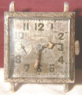

Hello, Great forum. This is my first post.
I would like to get information on refinishing dials. Is it all hand work or can computer graphics be used somehow? The kind of work I see on restored dials is hard to believe... wonderful.
I recently bought an Illinois wristwatch with a very dirty dial. Is it possible for a novice to clean and restore it or must I have it done professionally? It is not only dirty, but I can see brass showing through the background color.
Thanks for any and all help. Jim
P.S. What model is this?

Jim RobsonI did a search on dial restoration and I can see that it is for the pro's only.Thanks, Jim

Adam M. DubinThat one
does look like it's in need of one...

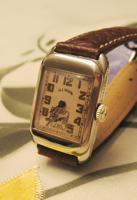

This is one I had done recently by International Dial. The finish is what they call "Dark Radium" or "Antique Radium". It's not perfect, but it's about my favorite of what they do, and for $30 or so, I'm pretty happy. They will do the hands (these are the originals) for another $7 or $8, and I have been really pleased with the ones I've had them do. They currently have a Hamilton Cushion of mine in for this same treatment. I'll post pictures of it when it returns.
The watch is an Illinois Futura, and it's a work in progress.
Cary

Adam M. DubinCary, looks like they did a pretty perfect job! For comparison, here's an original dial on my Wentworth.

Jim RobsonWow... it's hard to believe such precise markings being done with a pantagraph. And the pricing is also unbelievable.
Cary, It's difficult to see any imperfections in your dial. It surely looks good to me.
