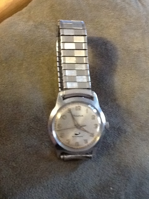

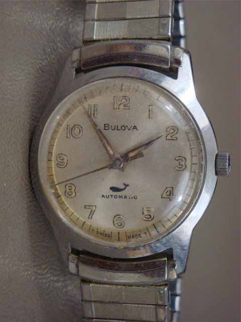

Gary E. FosterI want to replace the crystal, the old one was glued in and came apart during removal. I have replaced pocket watch crystals, but no wrist watches, tried a couple- glass- that were close but a little bit under diameter. The sweep second hand touched on both.
Measured the bezel diameter, about 28mm, height is a bit sketchy about 4mm. I am thinking a high dome plastic crystal would be correct, but not sure. There are so many styles. I have a crystal compressing tool. Any advice appreciated.

Peter Kaszubskigo with hi dome and get crystal 28.2mm
so once compress will fit tight.

Gary E. FosterThanks Peter, the new crystal made a huge improvement in the appearance.
