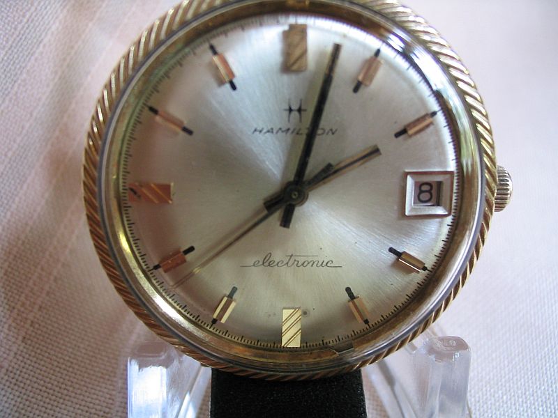

...well, I've had this Hamilton Electronic under the microscope and still can't determine how to open the case and replace the weakening battery...

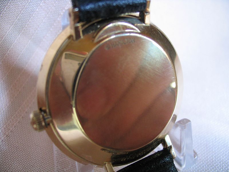

September 08, 2005, 13:53
Jim Cope...a look at the back...appears to be sealed...

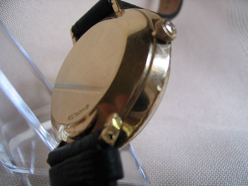

September 08, 2005, 13:54
Jim Cope...a view of the side as well...any ideas?
September 08, 2005, 14:04
Samie L. SmithJim maybe it comes out by removing the crystal ,or is it a water tight crystal..

Jim Cope...thanks Samie, Kevin...yes, I believe the crystal would have to be removed in order to access the movment in what otherwise appears to be a sealed case...the problem is how is the crystal removed and then how is the stem removed in order to remove the movement?...I 'member now that I bought this 'piece from Rich Kuhn maybe he knows...

Samie L. SmithJim is the crystal glass or plastic ,,,a lot of these you have to use a crystal lifter to remove the crystal (if it,s plastic)..probaly has a 2 piece stem if so it will slip right out the front ,may have to turn the stem a little to get it apart...

Scott CerulloThis might be one of those cld watch cases Hamilton used.  If that is the case, there should be a lip on the bezel at eh 12:00 position.  The bezel should be removed with a case opener, and then the crown should be turned so that the two piece stem will allow the movement to drop out when the case is turned over.

Dave FreemanJim,
     to install a new battery you need to remove the movement from the case as follows:-
* Pull out and remove the winding stem. It's a split stem so be carefull.
* Remove the crystal with a crystal removal tool.
* Remove the movement to get access to the battery.
After battery installation re-install all the parts in the order you took them out.
If in doubt go to a jewellers shop which has the correct tools or send your watch to Rich Khun.

Cort MooreDave has the right method but I'd remove the crystal first and then rotate then crown with the dial down. The movement may just drop into your hand.
