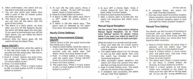

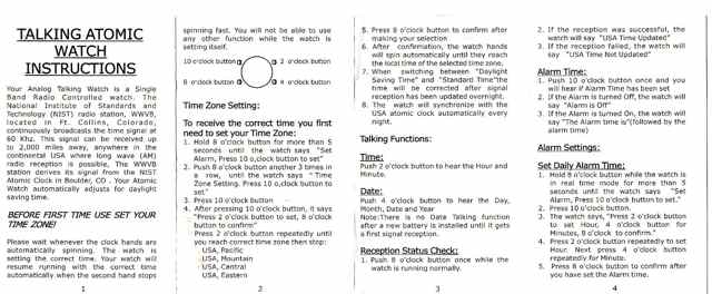

Here is the instruction sheet for an Atomic Talking Watch.

Page 2

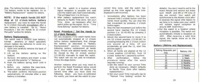

Page 3

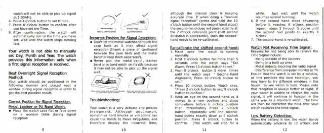

Page 4 I hope these help someone!!
