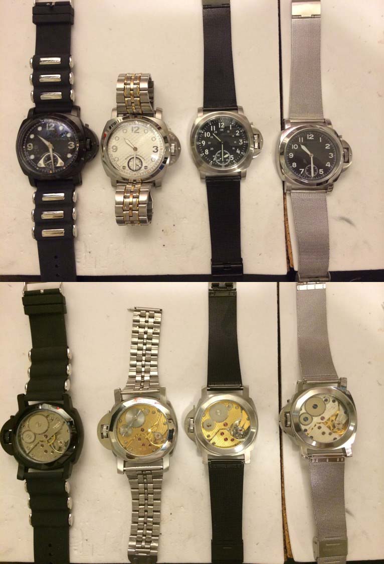

I have always wanted to make a wristwatch and with the coaxing of our very own Peter Kaszubski
("I just made wrist watches ...") I decided to make some. I used Panerai style cases and Swiss movements. The 2 on the left are 47 mm behemoths while the ones on the right are 44 mm nice size wrist watches. The black one (affectionately know as “Midnight”) sports a Colibri Silver Hammer finish 6498 from 1980. The white one (“Frosty”) has an Arnex Gold Hammer Finish 6498 from around 1978. The dials are Swiss aftermarket from an online auction website. The two 44 mm watches have brand new Swiss 6498 Silver and Gold Hammer Finish movements that I swapped the plates on and blued the screws on one to give them a different look. The dials are from Ofrei Watch Company. I wear the two 44mm watches as the 47 mm ones are a bit big for me, but the only ones that could handle the 38mm dials. Nothing quite like buying a suit to match the tie, but hey, I started off with one watch and ended up with four

Peter KaszubskiHmmm I got 4 my self
Nice watches like the first wrist band from left
where did you got it from.
All 4 looks real good, good work .

Dan CarterThanks Pete! Like I said you kinda gave me the push to just try and build something!
I picked the bands up from various online sellers at everyones favorite auction site
. I like the chain link bands the best because they are slim. Midnight and Frosty have 26mm bands. The 44mm watches have 24mm bands. Midnight looks like Batman's Utility belt to me

John WillisHi Dan; just a note to say I like your watches. I have never built up a watch but sure looks interesting. I am not very big so I would have to have help to carry one of those but yours sure look impressive. Way to go!!
January 10, 2014, 00:06
Dan CarterThanks John, I felt the same way about the 47mm ones. They are a bit large on the wrist, but do look nice. I think the 44mm ones look fine and do not take up much real-estate
. Building them can be pretty fun though!

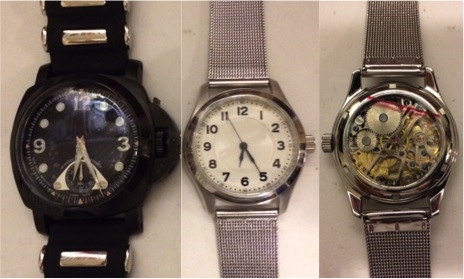

Dan CarterHere is another watch I built. It is on the right, with a picture of the back inserted as well. It has a Chinese 2650 movement that has both gold and silver plates. I blued the screws also. It measures about 36mm without the crown. I have "Midnight" next to it to show you how big (or small) it really is.
edit: I had a different pic here before that I swapped out.
Dan

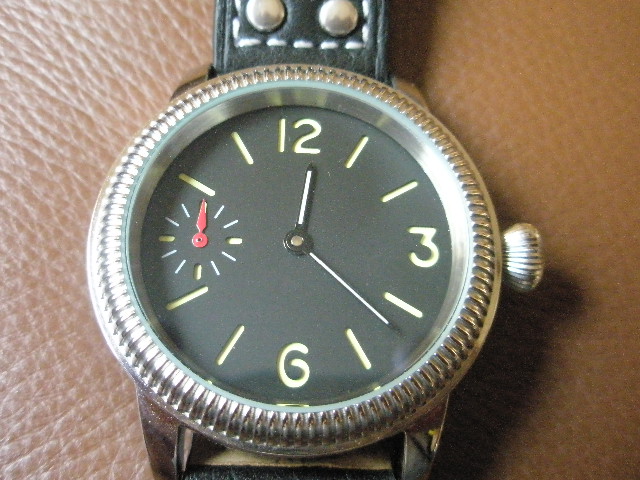

Peter KaszubskiMade my first homage to Panerai

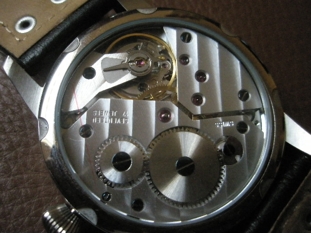

Peter Kaszubskiand back

Dan CarterNice watch! I like the simplicity of the Panerai Dial.
