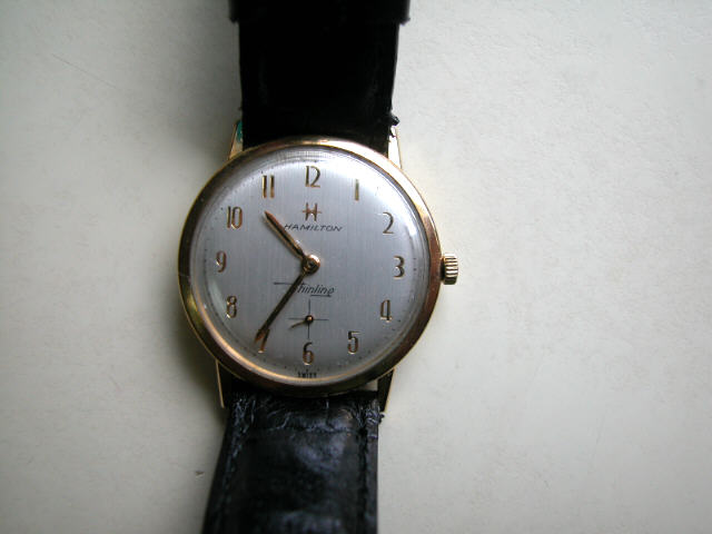

Here are a few pictures of the Thinline. It's marked Swiss on the dial at 6.
Hamilton Thinline

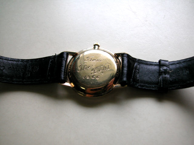

Here's the back, nice engraving dated 1966. !0K gf, no wear through, case back marked Hamilton

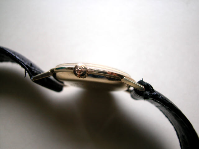

Hamilton Thinline stem side, crown marked with a stylized 'H'

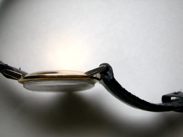

Thinline side opposite stem. No visible seams anywhere top, back, or sides.
May 13, 2004, 20:52
Rich Kuhn
John,
This is a one piece case.The movement must come out from the top. To remove the movement you must first remove the crystal. This style has a two piece stem. Some people try to pull the stem appart and some times this is the only way to do it. I prefer to keep moveing the crouwn while lifting up on the dail until they sepperate. If you elect to use the pull apart method be prepaired to buy a stem.
