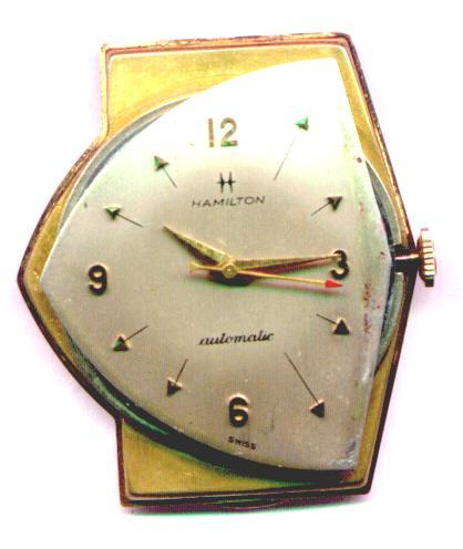

A few notes on authentic Pacer-matics --
It must have a 667 auto. movement.
The dial must be silver, and preferably not refinished. The word "automatic" is in script with a lower case "a".
The dial feet should show no signs of having been moved.
The movement ring is a simple nickel plated circle of metal.

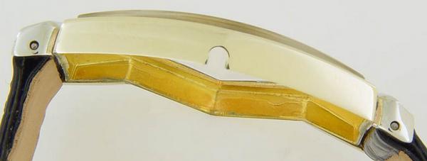

The case bezel is notched to fit over the movement stem.
dan.
pacer-matic
February 21, 2007, 20:31
Dan Mitchell
Case bezel and movement below ---

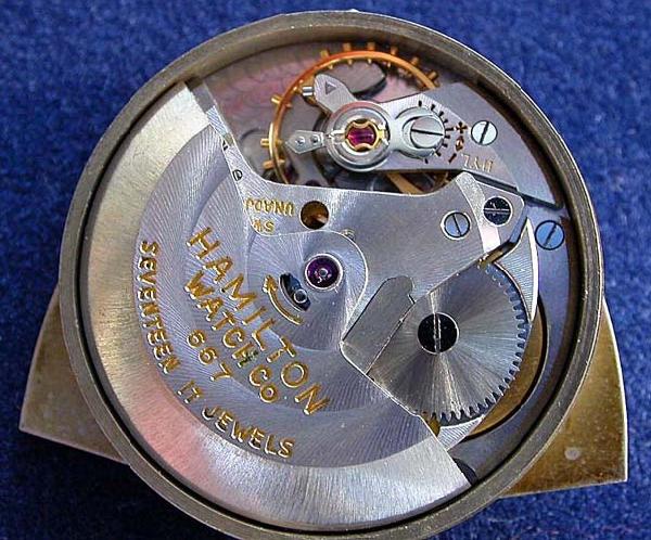

667 movement and case ring --- movements are not numbered so no help in identifying.
