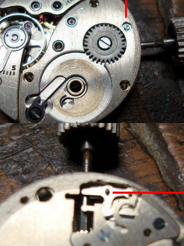

I agree with Roger but if your curious the crown maybe attached with a detent-stem system, a junk Elgin military wrist watch I have is made this way. If you search for detent stem on this site you will find advice on how to loosen the screw to remove the crown.
Below is a photo of my Elgin, the screw holds a plate under the dial that keeps the stem in place, but you need to read about the hazards of going to far with this.

Well I digress crown replacement is a simple job, You will need a casing cushion, the correct case opener to prevent damaging to the case back, a selection of screwdrivers, pin vice, rodico, correct size crown of course, the correct lubricant for the crown and case back, crown gauge would be nice if you need to make adjustments there is a long list of tools to add and of course in any water resistance is to be verified a long procedure.
We are also assuming that the stem is correct length for the new crown as the person who fitted the oversize crown , may well have hacked a bit off to fit the new one there is a long list of things that I have seen done to make incorrect crowns fit and of course glue!.
You simply slacken the detent screw (while is set position to hold the clutch and bevel pinion together), testing to see if the crown is released, slide out if it doesn’t come out easily don’t keep unscrewing the detent screw it will fall off and you will now need to remove the hands and dial, once crown stem removed, hold stem in your pin vice or lathe (not pliers) and unscrew the crown, assuming a 1 to 1 exchange screw on and reverse the above, don’t forget to lube to seals, gently tighten the detent making sure it catches the detent slot if not you may tear the threads out of the detent as it tightens at a angle. of course one slip with the driver and you could destroy/mark the movement, and dust dirt getting in may result in needing a full service.
