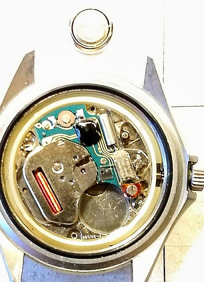

Trying to help a friend out on this Hamilton.  He spent $200 already!!! for repairs and the shop sent it back telling him it was unrepairable.
Anyway, it's a ETA 963.116.  I can't find a replacement movement or an equivalent.
Need to figure out a way to bail him out.

Peter Kaszubskidial side day.date?
Looks like 11,5 size if so any 11.5 eta or ronda movement will do as long as the day date is in same position.
December 14, 2017, 19:06
Peter KaszubskiBut ronda 515 should works

Dave TurnerThanks Peter,  Think I've also learned that an ISA1198\32 will work?

Peter KaszubskiCool I will know more tomorrow as Im not home and do not have my cross reference book with me.
But check the thickness and you will know for sure.
http://www.ofrei.com/page_196.htmlDecember 15, 2017, 08:54
Dave TurnerThanks Peter,  I'll take some measurements.
Appreciate the reference.

Peter KaszubskiI can't find any references for interchangeability.
 on 963.116

Dave TurnerLuckily I won't have to make a decision on a movement.  I called the shop that did the work.  It's still under warranty and I'm sending it back to them.
The owner evidently has had some memory lapse!
