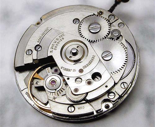

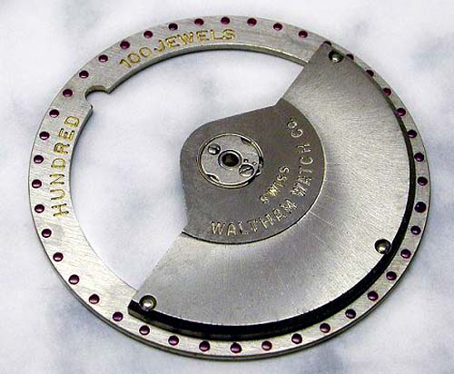

About over-jeweled, and non-functional jewels in watch movements, the all-time silliest one was probably a "100-Jewel" Waltham made in the 1950s. As you might image most of them served no real purpose. Seems they drilled 84 holes in the outer edge of the rotor and put 83 so-called "jewels" in 83 of the 84 holes. When you add the 83 around the rim of the rotor to the 17 in the ETA Movement you'll total the magical "100-Jewels" claimed for the watch.
Maybe they'd originally intended to claim "101-Jewels" and thought better of it! In fact the rotor itself is not jeweled in the center which of course would have been considered functional. The only purpose for all those "jewels" around the edge of that rotor might be to avoid momentary metal to metal contact if the watch were to be slammed hard.

An "83-Jewel" rotor from "100-Jewel" Waltham watch...

Ordinary ETA-1700 movement in "100-Jewel" Waltham...
