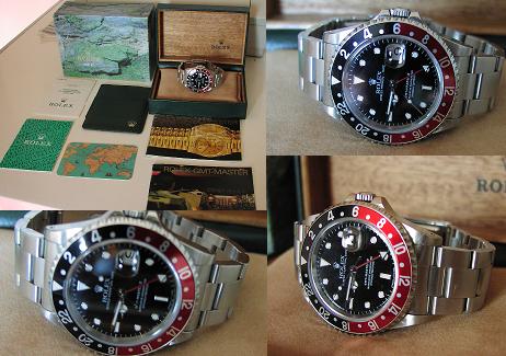

Bernhard SchmidtIs this an original Rolex??
....ok it´s not that good picture but does this one looks original to you?
Best regards!

Dave FreemanBerhard,
from your pictures it's too difficult to say, ther are so many excellent look alikes these days. What are the dial and case markings, serial number in between the lugs ?? What's the movement inside ??

Dave FreemanBernhard,
looking only from the outside of the case can be difficult. But as I mentioned before, look for the serial number which should be engraved inside the lugs, this will most likely mean you'll need to remove the bracelet to see it. Then check the serial number against a known Rolex serial listing (e.g. Cooksey Shugart or other reference book).
If you're still unsure, you'll need to have them take the back off. This way you'll be able to see the movement, and the inside case markings.
As John Duvall has mentioned, also look for a jumping second hand. I know Rolex has made/does make a few quartz watches, but they are not seen very often. So as a general rule, I'd say beware of the jumping second hand !!
Sorry but there's no easy way to tell. I know a Certified Rolex Watch Repairman who bought what he believed to be a genuine Rolex ( similar to what you've shown ) only to find out later it had a Seiko automatic movement which had been glued in place !! So even the experts can get fooled at times.
My advice when buying a Rolex buy from a reputable dealer/supplier and most likely you'll be OK.

David FahrenholzThe picture really do not show much but sometimes some of the fakes have errors when recreating the Rolex name, the "symbol" will be not as sharp and so on.
