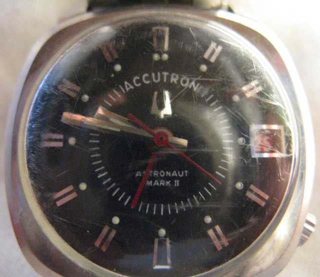

Hi all,

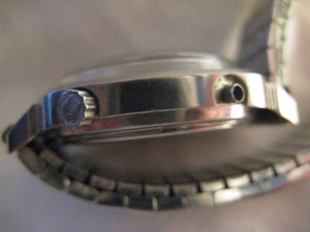

I hope I do not get the wristwatch bug as I have the pocket watch bug, but I picked this watch up very inexpensively and was wondering what the collectability and scarcity of this particular watch is. As stated it is an astronaut MkII, with black dial, 2 time zone, date feature, I do not know what is wrong with it short of needing a new crown and stem, crystal, and likely a battery. I have not seen one like it to figure out value, to know whether it will be worthwhile having it fixed, and comments on value, rarity, and collectibility would be appreciated.
Bill

That's a nice one to start with Bill. I love the look of the case and the Astronaut series are very collectable.
You really can't go wrong with fixing this one up, unless it does not run, and then the cost of parts coupled with the repair of the movement might push it over the edge.

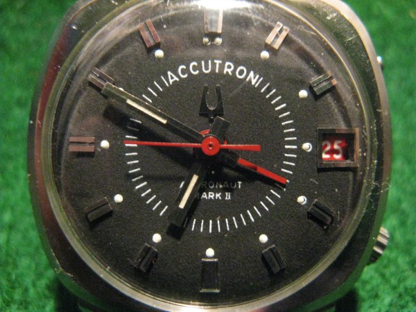

Here is a web page that has a restored version of your watch,(1969 stainless steel with black dial)shown.
Astronaut mark 2

I'm very familiar with that model, it's a scarce one. When restored, I sell these for $395 up, so yes it's possibly worth fixing.
THE GOOD: Dial looks to be good, case too, it has the red "stick" dual time zone hand too, these are impossible to find.
Now, I don't know what you pd for it, but here's what you're in for.
1. This is a Mark II model. Unfortunately, there's probably an all to common reason the top crown is missing. THESE ARE FOR ADVANCING THE DUAL TIME HAND ONLY, NOT FOR SETTING TIME! People try to pull out on the top crown thinking they are setting the time...and end up tearing the stem and crown out! If that's the case you might have trouble finding the parts.
2. Yes, sometimes they will take off and run with just a battery, and sometimes not. You may be looking at a bad coil/and/or/ index wheel. People don't realize these are just geared watches with an electronic power source, and if not cleaned regularly, and left to run, the internal gears once dirty start to chew themselves up. The index wheel in particular. You'll know that if you get power but the hands don't advance.
3. You'll also need a crystal looks like.
I would estimate best case you'll need a cleaning crystal battery and crown...$150-$200
Worst case upper stem assembly, crown, cleaning, coil, possible index wheel, and crystal...$350
So, to sum, get a battery in it and see if it takes off. If so, it's probably worth fixing. I have several models of the dual crown astros in my collection and in stock. It's my favorite. I also have a RR Approved Mark IV I'm going to sell.
If you need help or want an estimate you can send it in to me I have a certified Accutron tech here that can restore it as reasonable as anyone. He'll let you know what you're up against price wise and give a free estimate. Then you can decide.
Lastly, Peter is right. They ARE addictive!
Good Luck!

Do you feel that you can come up with a stem and crown for the upper 2 zone setting ?

picture please of the buffed out crystal.
June 21, 2012, 09:55
Bill Manders
Peter,
Here it is, the camera picks up far to much, including the strands of I don't know, and glare.
I have never really been much of a photographer, but it looks about 100% better.
Bill
June 21, 2012, 12:00
Ray Hallenbeck
Wow, what an improvement. This watch was meant for you. Most will not start up so easily with just a battery change. And that crystal sure came out nice. Im wondering if the missing stem and crown is different than the one in the watch?. If they are the same, it should be easy to find.
June 21, 2012, 12:46
Peter Kaszubski
nice its a keeper in my book.

If the crowns and stems are the same in the movement, DASHTO sells the white accutron crowns for about five bucks.

Bill what did you use to buff that crystal(plastic)and how?
July 13, 2012, 23:10
Bill Manders
Peter,
Sorry it has taken so long to respond, I am now on holidays.
I took some "Brasso" and gently rubbed it on the crystal for about 1/2 hour and it cleaned up very nicely, I would think that this would only work for plastic crystals though.
