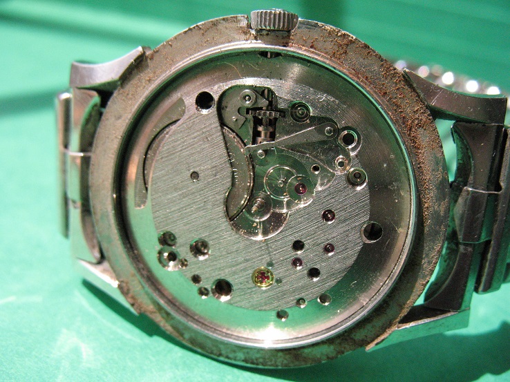

This watch has me baffled. The back is solid and does not pry, nor screw off. As a result I can't figure out how to release the stem.

Gary E. FosterMike, the watch may have a 2 piece stem, if so, the movement comes out thru the front. You put the stem in set position, I usually use a pair of tweezers placed between the crown and the case, gently try to use leverage to separate the 2 pieces, the stem is a sort of ball and socket arrangement. The 2 pieces will snap together with a bit of pressure to reinstall.

Robert ButlerMike, before trying to force the two halves apart, try this trick below, as I have snapped a split stem female joint by using the lever method.
As you can see from your first photo, there is a small cutaway in the edge of the movement plate adjacent to the crown to facilitate the method below, by allowing you to see (with a loupe) the position of the stem male/female joints.
Push the crown in, then tip the whole watch upside down over your hand, gently wiggle the crown a tiny amount, and keep repeating this process until the movement falls out into your hand, as the two halves of the stem separates, leaving the crown and its stem half in normal position. Sometimes it may be necessary to jiggle the movement a little with a spare finger, to coax the seperation.
To replace the movement, make a note of the male and female halves of the stem, ensuring that the part in the movement is in a position to slot back into its matching part in the crown. Gently slot them together, and if it does not go straight back in, try slight repositions of the crown until the two halves are mated and the movement is back in the case.
This may sometimes take a little while to master, but is better than trying to source a sometimes rare new split stem after breaking the original.
Bob.

Mike HodgeThanks Robert. It looks to be a better watch than I originally thought. I'll try some more to get the stem off. As you can see it is quite dirty and probably stuck together. Neat add.
Success! I was able to get the stem parts separated. I believe it's the first time since they left the factory. Case is marked L9 so must be 1959. Now to make it work.
Thanks to Peter, Gary and Robert. This didn't just fall out so I believe it had never been taken out. There are no jeweler/watchmaker marks in the case so it's probably been in there since '59.
