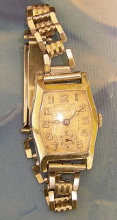

Cort MooreHere are two pics of an old Rhodium plated case.
I would guess it dates to the late 1920s. I took the first pic on my mouse pad with a flash light so the mirror chrome color is off. The reason it is interesting will be apparent in the next pic.
-Cort
January 18, 2007, 00:56
Cort MooreThe inside reveals the case is bright orange and 18K gold!
I must add that this case was aquired empty for five dollars. It was a while before I found a stray movement, dial, hands,crown,crystal, band.........
At least I didn't scrap it! It runs fine too!I've hauled it from show to show but have found no interest in it(full disclosure may be working against me). Actually, I'll be sad when it does finally go as we've spent a lot of time together
I should mention that, although it seems screwy, the plating of 18K gold is a completely logical choice. Because 18K is virtually tarnish free it bonds extremely well to plating. There is no plating degredation on this watch.
-Cort
