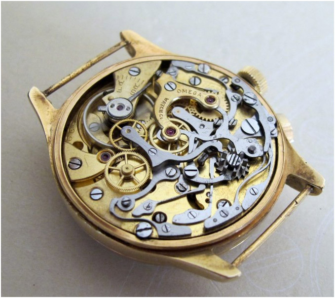

Hello,
I am having a doubt about an Omega chronograph movement.
I received pictures from it and I cannot confirm if it is an Lemania 15XX.
Could one help me? Bellow is the pictures that I received.
Tks,
Paulo
July 23, 2014, 08:12
Gerald Zimmermann
No doubt
Sure from the evolution line of the lemania 15 omega/Tissot 33.3 movement family.
With the movement rotated and tilt in a proper orientation you should find the right one.
Gerald
