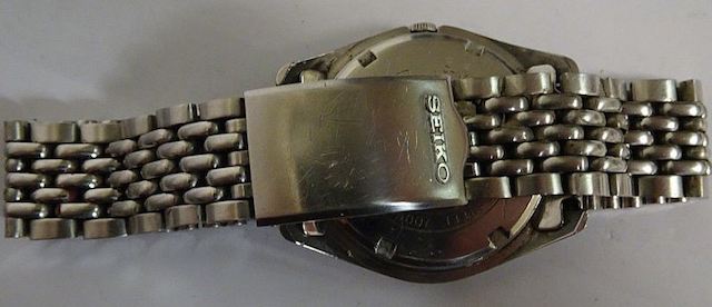

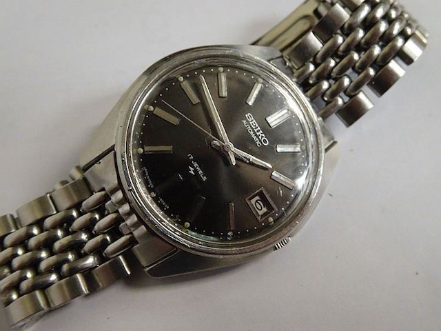

Got a question for the Seiko experts. Did this watch come with this band originally?

Most Seiko came with metal, divers with rubber strap not all but most
that looks original to me (beads of rice) bracelet

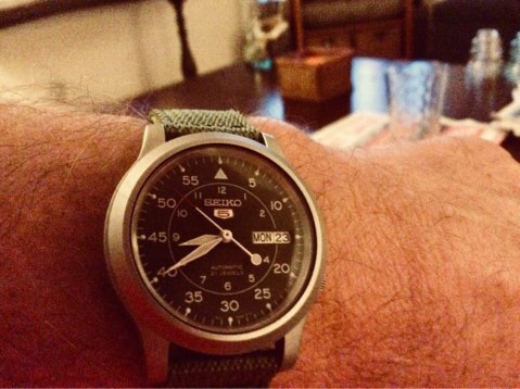

Can I throw in a jomashop seiko 5 got last week.
Green fun , this is a great cheap one.
Another hairy wrist.

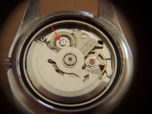

Update on the old 7005. Got the back off and discovered the automatic winder is not engaging.
Wonder if that's just dirt.

Dave with screwdriver try to wind it on the screw with the arrow I made on picture

Thanks Peter, I already did that. It's been running great for nearly a day now.
So, If I can figure out what's wrong with the push pull palls or the wheel it winds, or whatever else it is, I think it will be a good old watch.
I'm going to open her up and take a hard look at that part again. Might be dirt?

The Seiko runs steady for two days or so on a full wind.
Think I've narrowed down the problem to loose bearings in the rotor. And I can see telltale signs of wear against the outer bridge plates.
So, what is the cure? I guess mainly, where can I get parts? Or is the rotor repairable?

I would buy movement/parts from ebay and replace worn down parts/rotor to keep it original
