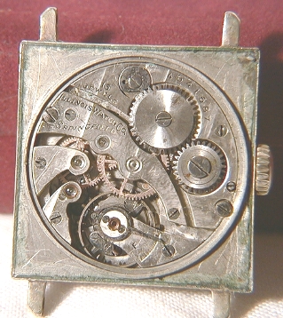

Since I don't currently have access to the Illinois Watch Co. book, I was hoping that someone would help me with the nomenclature of this movement. It seems to be a very common type.
Since the photo isn't too clear, I'll list the markings; Illinois Watch Co., Springfield, 15 jewel, 4641687. It has the seconds at 9 O'clock.
Also is their a database of serial numbers that will help me put an age on it?
Thanks, Jim

According to the Illinois Encyclopedia compiled by Bill Meggars and Roy Ehrhardt your wristwatch is from a run numbered 4641001-4642000 inclusive. Illinois production records published therein list it as a 15-Jewel, Grade 903 from 1925 production.
Hope that is of help to you.

Jim RobsonLindell or anyone else, If I look through parts catalogs I see 3/0s Would that be the size number I'm looking for? I need a balance staff for this movement.
Thanks, Jim
February 13, 2007, 10:45
Jim RobsonI found some size charts on the web and I think I have figured it out. The movement measures 25.4 mm (Within 3 significant figures)which is an inch which is the size of a 6/0 movement. Not only that, but I just noticed that the case is marked 6/0
I don't know much, but I'm motivated to learn.

Sorry Jim,
I neglected to put the fact yours is a 6/0 movement in my earlier post. You are correct, that's what it is. By the way the listings line for 4641687 which is 4641001-4642000 shows that particular run as being "lever-set" and there are other listings for pendant-set models of that same 903 grade.
My presumption is of that lever-set part of the listing being a misprint or modification.

I removed the balance cock today and learned that someone had removed the balance staff and left me with a balance wheel and a spring. Be greatful for small favors. I was able to order one at McCaw. You guys are having rather bad weather today so he will ship later in the week.

I just got some bad news however. Since the balance staff was missing completely, it was also missing the impulse pin roller, and I'm learning that this roller is difficult to find in the NOS market. Maybe I'll have to buy a donor movement that has one.

Jim RobsonHello again Lindell and others, I just tried to order that impulse roller and the vendor said that I need the "Series" number in addition to the 6/0s and the Grade 903. Are you aware of what he is talking about? He didn't want the serial number so I don't think he was talking about the 464, but now that I think about it, maybe that is the series number. What do you think?

Samie L. SmithJim it,s a 15 jewel 6/0 size model 1 grade 903 i have a few of these parts movements but i will have to check and see which grade they are..parts for these can be hard to find but you might try these folks ..sounds like you need the roller table and roller jewel.

Jim RobsonHi Samie, I wouldn't want to canabalize a working movement for this project, but thank you very much for your offer. The part I need is the little spindle that fits on the bottom of the balance staff. It has the impulse pin in it.
I have plenty of patience so I can wait for a parts movement with a good balance assembly. I just missed a basket case 903 last week on eBay but I didn't know I needed it at the time so I didn't bid quite strong enough.

Jim RobsonP.S. I now know what a roller table and roller jewel are and you are correct (I'm just learning nomenclature)
February 16, 2007, 17:59
Jim RobsonHello, After seeing many drawings of the lower part of the balance staff, I began to worry that I would also need a safety roller below the jewel so I removed the balance assembly from the other 903 that I have and drew a sigh of relief when I saw that the Impulse Pin Roller on that watch was all one piece roller-pin-roller. At least now I'm certain that I'm only looking for one part.

Samie L. SmithJim a word of caution be sure and check the balance jewels in the watch and make sure they are not cracked or a piece of a old balance pivot in the jewel,if you try a good balance from another watch you can damange or even break the pivots on your good balance..

Jim RobsonSamie, Thanks for the tip. It does look like something is stuck in the jewel. As soon as my second hand puller arrives, I'll remove the dial and know for sure.
Thanks again, Jim
P.S. One vendor I talked to looked up the Illinois part number of the table and jewel. It is 2003
