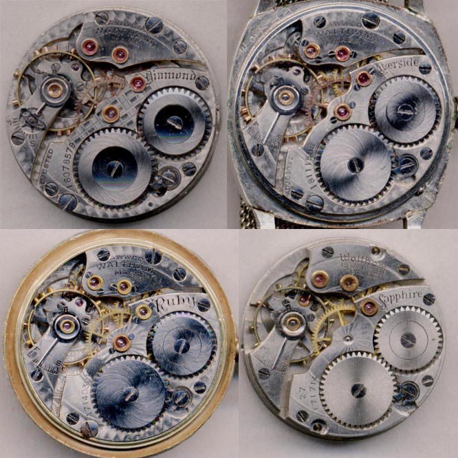

Is the jewel name sapphire, ruby, diamond on these movements an indication of grade and which is highest and lowest? I am assuming that ruby is a higher grade than sapphire, but we know that assumptions are sometimes dangerous.

Jerry TreimanYes, these are grade names for the better of the 6/0 size movements. 1911 and 1917 catalogs list four grades: Diamond, Riverside, Ruby and Sapphire. A 1921 catalog only lists the Riverside, Sapphire and a 7-jewel unnamed model. In addition to wrist and pendant watches these were also the movement for the stylish and thin Opera Watch.
The "Diamond" grade has 17 jewels and was the highest grade in the jewel series. It was also produced marked both "Diamond" and "Maximus". It has a gold train, gold jewel settings, diamond endstone and was probably position adjusted. The later "Emerald", although more highly jeweled (21) does not have anywhere near the finish of the Diamond or Maximus.
Next in line, below these, are the Riverside (17j with gold settings), the Ruby (17j or 15j) and the Sapphire (15j), in that order. There were also some unnamed grades (7-15j) in this size, but although 6/0 I suspect may not have been considered "jewel series".
