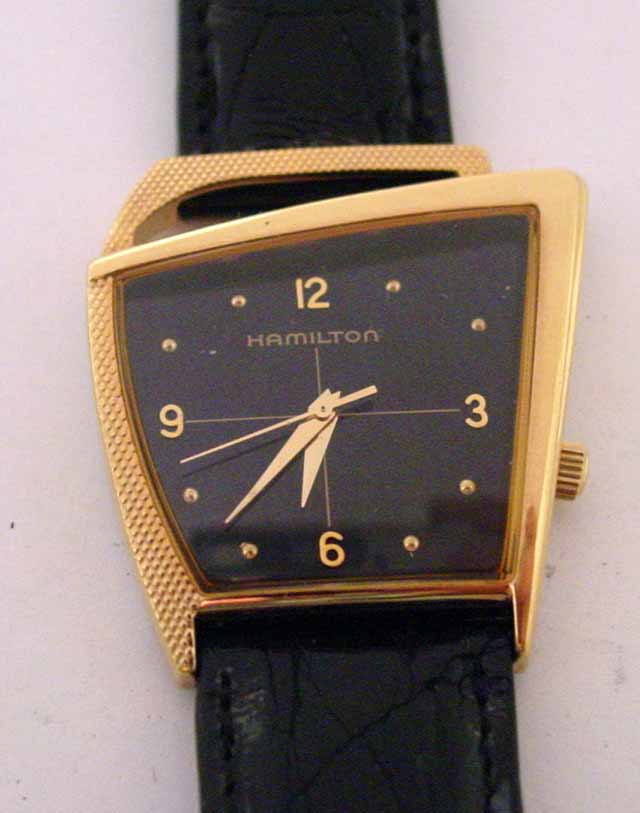

This watch I picked up the other day and wasn't to sure about what exactly it was. At first look I thought it was a junk quartz but after looking at it more I am unsure. The movement looks better than the normal baterry watch as it even has a coil with 7 jewels. Has anyone ever seen these before and if so what is it.

Hi Robert. From what I can deduce from my Hamilton book, what you've got here is a "Flight II" from 1961. The two models that they show in my book have gold or silver dials, and 10K gold filled cases. But, after looking at the back of your watch, a couple of things stick out...the "Registered Edition" and "Base Metal Bezel". This could be one of those Swiss reproductions from Swatch, who own the Hamilton name. Regards, Brad

Thanks Brad I figured it was the newer swiss made model but I never knew they used better 7 jewel quartz movements I thought they were all cheapies, or at least the ones I remember seeing. Was the earlier Swiss ones better quality than later ones, maybe I just never seen an earlier one.

Hamilton "Reissue" in quartz. I currently have a Hamilton Bolton in the reissue model. I have seen other models that were also reissued. The ones I have seen have a registered number on the back.
