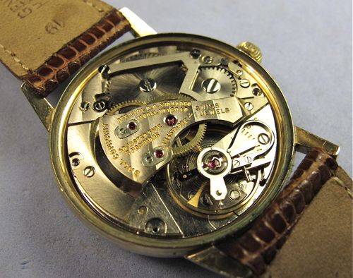

I recently bought this very nice Ball wristwatch from John Grennan. I have managed to remove the back cover and was hoping someone could help me identify the 21 jewel Swiss movement. It is manual wind, adjusted to 5 positions, and under the regulator spring are the letters "BXC" (maybe Bulova?) I would also be interested in knowing the approximate year of production. THANKS

William ThomasLook under the balance. It should be marked AS 1604B. (A. Schild 1604).

William ThomasWhat is stamped on plate UNDER the balance wheel? The importer code on the balance cock does NOT denote the manufacturer.

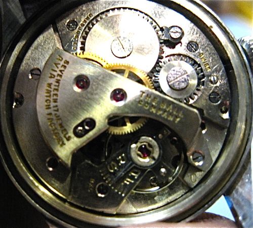

Bruce StewartWilliam, this excerpt is from the Wikipedia history of Webb Ball: "His original jewelry business in Cleveland grew into the Ball Watch Company (currently headquartered in La Chaux-de-Fonds, Switzerland), which used other watch companies' movements, perfecting them and then reselling them. Ball Watch Company also ordered watches complete from other watch companies. Ball used movements from the top American manufacturers, Elgin, Hamilton, and Waltham, and switched to Swiss Avia movements as early as the 1940s in their wristwatches. The Waltham Watch Company complied immediately with the requirements of Ball's guidelines, later followed by Elgin National Watch Company and most of the other American manufacturers: Aurora, Hamilton, Hampden, E. Howard & Co., Illinois, Seth Thomas, later on joined by some Swiss watch manufacturers: Audemars Piguet, Gallet, Longines, Record Watch, Vacheron Constantin."
Attached photo is from a Ball Avia circa 1945. The odd looking top plate has a similar look to the top plate on my later movement.

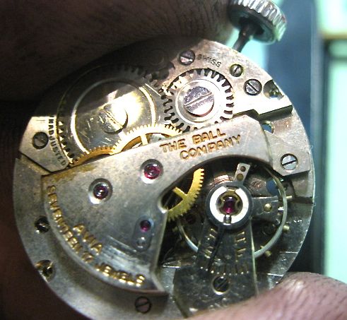

Bruce StewartWilliam, the only marking I can see under the balance of my watch is "WI". The gilt "BXC" is on top of the balance cock. Attached is another Avia Ball wrist watch example. Once again, it is earlier than my watch which I expect is from the early 1970's.

Bruce StewartWilliam, I think you are probably right. The attached photo of an AS 1604 is much closer in appearance than the Avia ebauche I posted pics of. I also found the following info on another watch forum: "I later learned (too late for the article, which was published in October 1972) that the Elgin grade 873 was an A. Schild cal. 1604B, 13-ligne, 21-jewel, center-seconds, seconds-setting, manual-wind movement, exactly the same movement that Ball used in their first Official RR Standard wristwatch. Still later, I was told by a railroad watch inspector that some railroads wouldn't approve the Ball RR wristwatch with the Swiss movement because it was available only from Ball, so Ball got Elgin to use it also! Like the story that the CPR wouldn't approve the Ball RR wristwatch because it was based on an ebauche movement, that story never made much sense to me, either, but take it FWIW as anecdotal. I do recall seeing it listed in some catalog as something like Elgin B.W. Raymond 21-jewel wrist chronometer. It was years ago, and I don't recall the exact wording, but I do remember the use of the word "chronometer" and the B.W. Raymond, and of course the fact that it was a wristwatch. The catalog was from some time in the '60s."

Bruce StewartWilliam, I have found proof-positive that you are 100% correct!!! I went to my database to correct the identification of the movement...as I was typing the 1604 I noticed that the serial number I had logged in when I bought the watch was 16049. I thought, "wow, maybe that wasn't a serial number I was looking at on the movement." I immediately opened up the watch again and checked the number under a 10X loupe....what I thought was a "9" was actually a "B". IT WAS RIGHT THERE ALL THE TIME
In gilt lettering on the top plate (you may be able to see it) it said "Model No. 1604B." Thank you so much for helping me nail this down
