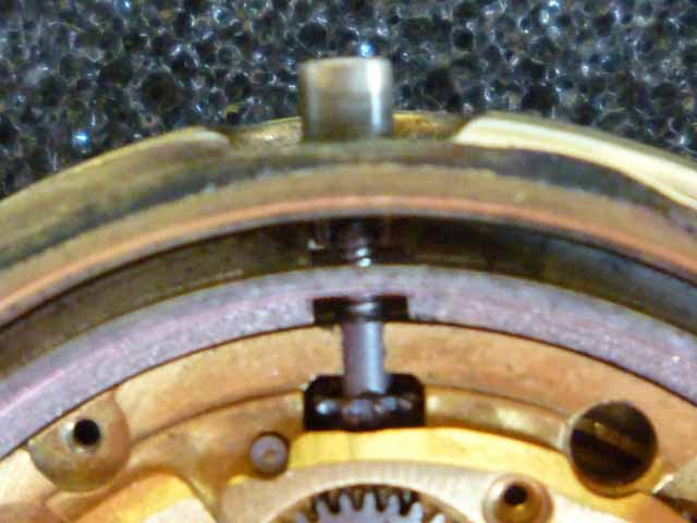

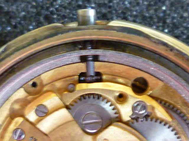

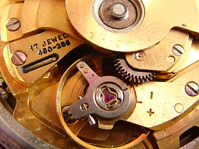

Pete can u post a pic of the movement please.
July 28, 2012, 07:05
Pete Riley
pic_1
July 28, 2012, 07:20
Pete Riley
pic_2
July 28, 2012, 07:24
Pete Riley
Pic_2, but it does show the stem, not sure if its broken as it does not seem to extend into the tube for a crown to be attatched

Dave Turner
From your pictures it appears to be a 11 1/4 ligne. And according to the BestFit catalog there are shown only 2 possible calibres that are automatics, 31 and 32 that interchange with 2 movements - BMZodiac70 and BMZodiac72.
And they both use a 1415F stem, or 397 if it's a split stem.
Dave Turner
August 09, 2012, 19:21
Francis Bowman
Hi guys, please correct me, the best fit book i have says that this is an AS 1250, which takes the 49F stem. I checked the BMZodiac70&72 and in my packets is a stem plus a crown, the crown is not new, but can look at some others i have there to see if i have a good one, but also i have stems for the AS1250 stem 49f..... Dave on the packet for the BMZodiac, my lot come from a watchmaker and he maked them the 70& 72 as same stem number..

Not sure if its a split stem or if the stem is broken, as you can see in the pics a stem is there but nothing to attatch a crown onto. most likely means its split ?

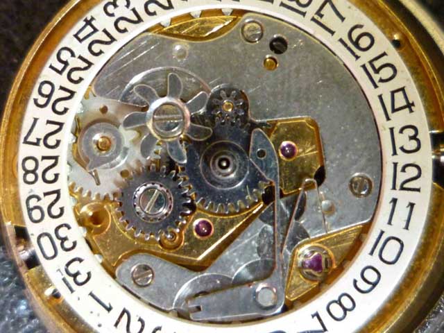

Pete Riley
more pics to show stem
August 10, 2012, 11:00
Pete Riley
2nd
August 10, 2012, 12:47
Dave Turner
I've studied the BestFit catalog again and find that GP used A. Schild, Peseaux, ETA, and Felsa ebauches in a lot of their watches. Until you know what you've got it's going to be difficult to get the correct parts. And to do that, It's going to have to be dismantled to a degree. The movement is most likely marked under the dial.
If you can look inside the stem sleeve with a loupe you can see a slot in the stem if it's split. Or, just stick a small screwdriver in there and try to wind it, to find out if it runs.

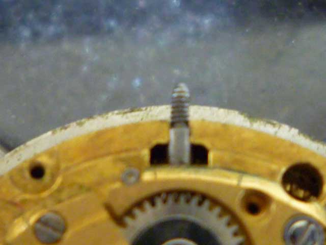

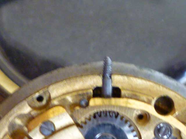

August 23, 2012, 10:16
Pete Riley
couple more pics, there is no slot on the top of stem as was suggested earlier,seems domed and threads are quite worn. stem does not extend to the bottom of the tube so either the crown extends through the case body or there is some sort of extension
any ideas ?

Francis Bowman
Pete, Dave is on the money you will have to see what or which makers is used here. I thought that the model number would be around near the balance. But as i do not know , Do as Dave suggested and look under the Dial. i have over 3500 stems so once u know what model is let me know and i will have a look see Francis

Pete Riley

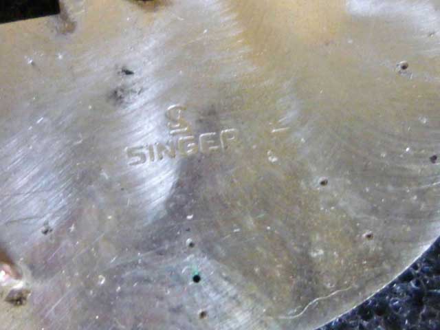

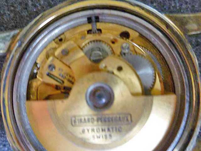

Well taken the dial off and........nothing !!
no mark or name of any kind.
Only info is "Singer" on the back of the dial itself.
see pics
August 24, 2012, 06:10
Pete Riley
2nd
