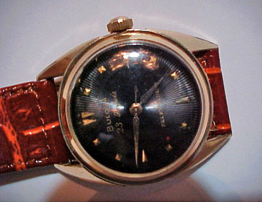

Here is a pic of the face:

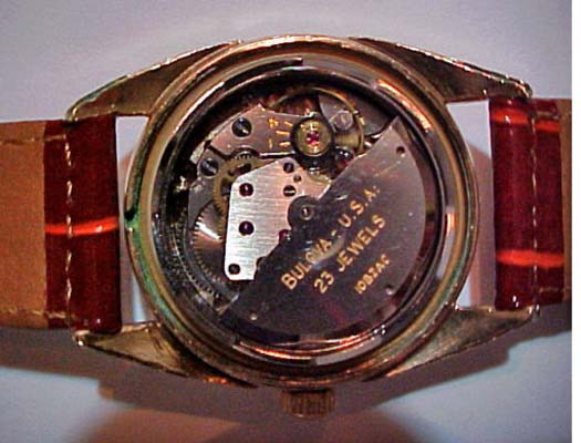

Ray HallenbeckHi Robert, I would question if it was truly COA as claimed.  All the dirt and grime under the case back would make me wonder.
Nice looking watch though, i like the textured dials

Robert EpsteinThanks Ray.....Yes you are probably right about the COA he claimed to have done.....That's fleabay for you....I wish my eye sight was better to be able to see these things....
