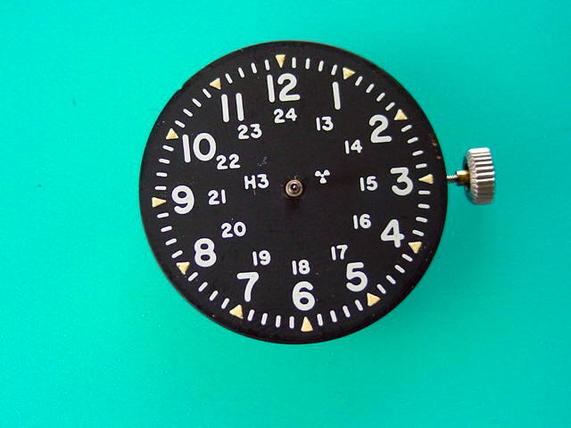

Can anyone tell me the caliber # on this military movement it is from 1979,i need to order a click spring for this,,My bestfit book is from 1962 so i don,t have any info from 1979..

Tom HuberSamie, I have one like that from my tour in the far east. Mine is marked Benrus. Mine is in the plastic case where the movement comes out through the front. These were actually drop accountability for the military at that time. That means that they were throw aways when they quit.

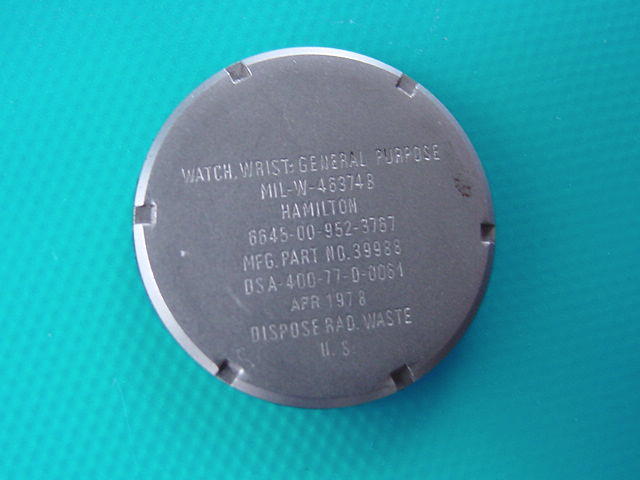

Samie L. SmithThanks Tom this one is in a base metal case military markings on the back.

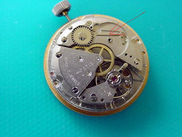

Samie is repairing this watch for one of our members.
Can anyone help with the part number of the click spring for the movement shown in the first image above? There are miltary markings including Hamilton origins on the case-back.

Tom HuberThat is interesting that Samie's watch has the Hamilton marking on the case back. My 7J Benrus marked movement is exactly like the one in Samie's pic. I wonder what supplier both Benrus and Hamilton bought their movements from to sell to the military. If we could figure that out, we would have the part number.

Julian J. SmithThis is probably a Standard Time Movement.They were(I think)movements from all the Ebauches SA companies made by ETA after things got tight and when the companies were being consolidated.

Cary HurtSamie,
I agree with Julian that this is a Standard Time movement, but I don't find reference for a 447 caliber. Standard used lots of ebauches by Font, A. Schild, ETA and others, so it's still probably best to try to find that actual reference.
My 1974 base metal cased military watch with Hamilton markings has a 17 jewel INT/DuRowe movement, marked H. W. Co. I think perhaps yours underwent a movmeent transplant at some point. I'll keep looking.

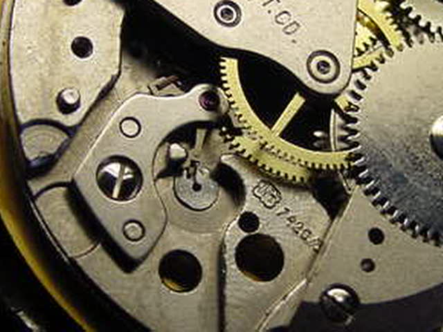

Samie L. SmithThanks Cary here is a close up under the balance the makers mark is weak and hard to see and the # 7420/3

Cary HurtSamie,
That's it then. It's an International/DuRowe 7420-3. Jules Borel lists a click spring combo for $7.50. I've got a pending order with them. Let me know if you want me to order it and I'll send it to you at cost.
