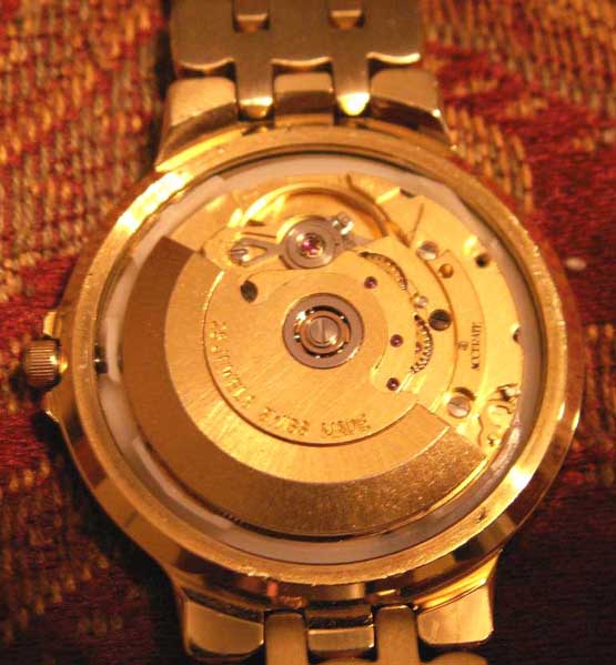

Peter Kaszubskican you post pictures of the movement.
January 02, 2012, 18:23
Joey HammThis is the best picture of the movement I could get, sorry

Chris AbellJoey,
Can you read the small stamp by the balance, more than likely reads ETA and a 4 numbers
January 02, 2012, 21:53
Ray HallenbeckHi Joey,
I wouldn't call your watch a fake, looks like the same ETA 25 jewel movement that many companies are, and have used in their watches. Looks to me like a nicely made "Accurate" 25 jewel watch with aptly marked dial and case.

Joey HammFirst of all thanks for all the input. The markings near the balance that I could read are 2824-2 and V8-75A (I think). I am just curious if the watch was worth $40? Also, do you happen to know how old?

Here is the the company its based out of Dubia I would need to see the movement to be sure either way if a genuine eta or not, if it is, its a good quality movement in a lower grade case etc.

Chris AbellRob, we are not disputing if the watch is a fake ie a copy of a accurate watch, the question is with the watches origin being where many replicas and low grade watches are created, there is a good chance they used the Chinese ETA movement as part of the manufacture seeing the plastic casing ring is not a good sign and they stating these are affordable watches etc if so, you don’t start with a expensive movement. The rest of the series are quartz low grade movements. The replica movements are popping up everywhere I often have to pass on the bad news, about two weeks ago I had a customer bring in his used $1500 Submariner, the price alone should have warned him it was not such a good bargain, I dont work on the fake/replica they are so cheaply made poor quality it never a happy outcome, I had person insisting his was repairable it was one of the so called high end replicas with a Swiss ETA movement fitted in a replica Rolex, even the ETA movement all stamped up was a fake in a fake watch!
