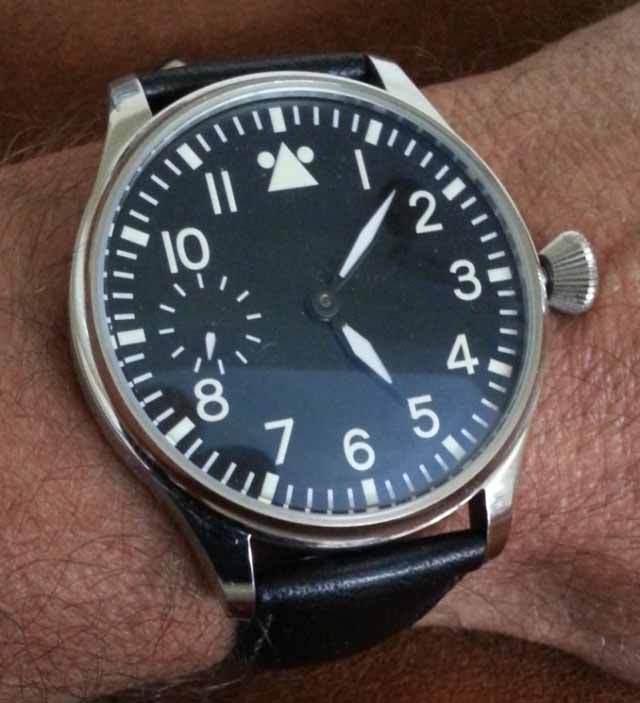

What great fun. I've always been interested in these. I stumbled in to the Tourby watches a year or so ago and have been fascinated with the idea since.
I picked up a distressed 917, performed a full COA and chased out a couple minor bugaboo's she had. Gummy click and spring, unseated main spring.
I landed an estate sale case (most likely hong kong) with a nicely done brushed stainless body, polished bezels and nice glass front and back. It's number 117/1000 if that means anything since I can't identify the maker.
The dial and hands are straight off the auction site and I have to say, I was really pleased with the quality of the fit and finish of both the dial and the hands.
I did have to modify the stem to accept the smaller thread pitch of the crown and had to toss the spacer ring that came with the case and fabricated one from some shim stock I had here at the house.
Many thanks to Chris Abel for making a high end band available at a very forgiving price.
The watch isn't really as big as my 6-3/4" wrist makes it look.

Paul D. TrombleyThe money shot. Now if I could get off my wallet and land a 921/923...

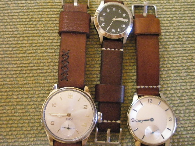

Peter Kaszubskigreat work .
and not to hijack your post few watches and hi end straps I made
June 07, 2014, 23:28

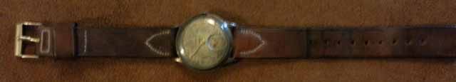

Paul D. TrombleyI'm digging those bands/straps... I love the old school (Indiana Jones) look.
I might need to make an Arizona run for a quick lesson in strap making...

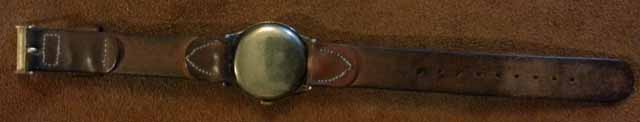

I bought this old Wittnauer for the strap... turns out, it runs like a champ and is real fun to wear.
Paul D. TrombleyI had a couple others, but they rotted off my wrist or failed at the pins due to a hundred years of sweat and neglect.
I like the single, large leather keeper and the simple old school leather. No tooling, no unnecessary stitching, no soft suede backing... all purpose, no frills.
I'm certain this one was hand stitched as well.

Dan CarterPaul, did you have to modify the dial, or did the feet line up? Also, the seconds area, looks like it matched pretty easy too (or is it an aftermarket dial made to fit 917s anyway)?
Love the look. I put one together with an asian 6798 and must say I like that dial and look, but having a nice Hammie would be pretty cool! Thanks for the posts!
Dan
June 08, 2014, 13:02
Paul D. TrombleyDan,
It turns out the dial and hands are purpose built after markets made to fit the 917/921/923.
The dial feet dropped right in and accepted the retaining screws perfectly.
The Hour and Minute hand dropped right on and gripped perfectly... the nicest thing is that the heights are perfect, I did not have to mess with adjusting clearances between the hands to clear each other on their sweeps.
The paint and lume were durable enough to tolerate installing them with my stainless steel Anchor-Titan #17 spoon with out chipping or cracking.
I did need to run a micro broach through the seconds hand tube to clear the paint clogging the entry. This broach also doubles as an acupuncture needle. I did this hand held because I was afraid to clamp the paint/lume hand in my tool.
These cases come available from time to time. This case is an estate case with no pedigree... I can say it is not a Tourby second and is most likely Hong Kong. The hands and dial are straight up Hong Kong.
If I can land a 921 or 923, I will spring for a Tourby "second" case and probably go for the Goulage (-2 spelling) dial.

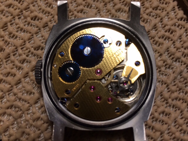

Paul D. TrombleyI really like the blue wheels... never considered that before.
I pulled up the bluing block site last night after I finished the Hammy conversion and realized how monotone it all looked compared to the high end offerings from the exotics.
I'm also considering some sort of plug or accent for the empty case screw holes that no longer have a purpose.
Bluing block question... so, after we get to 570 degrees and sit there for a few minutes for the color to take... what's next??? pull it off and quench it? Let it sit there and ride down in temp with the block? How do you lock in the color???
June 08, 2014, 21:35
Dan CarterThanks! As for cooling, I have always dropped the part into water to cool it down and usually if the part is going to change, it will show signs pretty quick (either the change to yellow or brown or even purple). If it either does not change or goes to a grey or a patchy blue, then the part is not polished / smooth enough.
As for the empty screw holes, maybe you could add a small removable plug with a flat top / head (maybe copper, or glue in a screw that has smaller threads so as to not require an actual screw driver to remove). The reason I say that is because you don't want to cause any damage to the movement even though you don't want to use the original case screws. Ok with that said, a flat cap or plug and then add lume paste to the top so you would have that little something extra on the back of the movement. Looks clean, but also has some zing if you charged up the lume.

Paul D. TrombleyWhat a difference a little color makes
I did the click and wheel screws deep blue, the plate screws are all matched at a much lighter blue.
