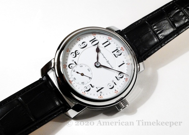

At the beginning of the year I purchased an Illinois 1913, 16s, 19j hunter movement in a wrist watch case. The case is excellent. with screw off bezels and a glass bezel on the back.
Unfortunately, It didn't run when I got it but I planned to send it off for a COA, which I did. When I received it back, it still would not run so it was returned for an additional look. No luck the second time & no explanation.
A few months went by and I sent it off to another watch repairman. The work was paid for but returned not running. Back it went the second time and returned not running with no explanation.
I finally sent it off to yet another watch repairman who straightened out a number of cumulative 'repairs' and 'adjustments' that had been made.
Here's what he found and fixed:
1. Incorrect balance staff
2. Superglued weights
3. Ruined collet
5. Loose stones
6. Warped escape wheel
7. Cracked jewels
8. Missing dust band
9. Wrong mainspring
10. Broken gooseneck
11. Wrong hands
12. Incorrect screws
13. Discarded minute wheel plate

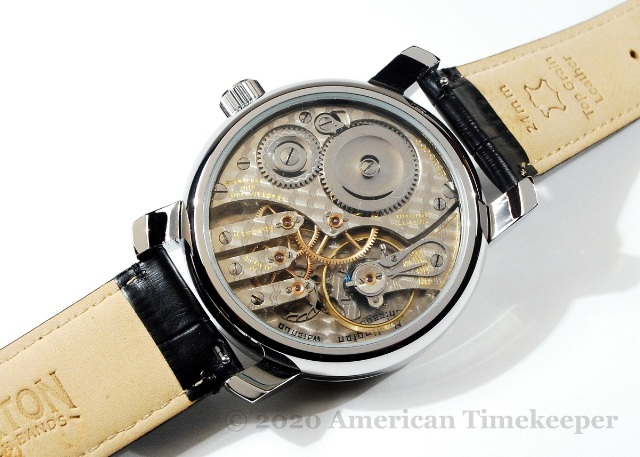

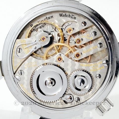

The balance staff was reduced to proper specification, the hairspring re-colleted, and the glued weights removed. The donor pallet had staff pivots of 0.19 and 0.21 mm, which were too small, and was replaced with one with 0.21 and 0.22 mm, respectively, and both pallet stones and the loose roller jewel were reset. The escape staff was being pinched between both cap jewels, so that was reduced for proper endshake, and the banking pins were run back out to allow the pallet bridge to sit down where it's supposed to. The balance wheel was repoised.
The missing minute wheel plate was replaced and the mainspring anchor was altered from a brace to a T-end. The odd case screw was replaced and correct minute and seconds hands were installed, and the dial whitened up considerably in solution. A small amount of enamel was missing from the lower Burlington signature, and that was replaced as well.
Because the collet was stretched when forced onto the incorrect balance staff and touching the hairspring, the watch sped up, so the repairer added timing washers to the balance weights, but they were for 12-size watches with a diameter that was too small. He forced them on the balance weights anyway, ruining the threads, so he superglued them to the balance wheel.
I'll post pictures in a while of the finished watch. If anyone is interested, I can post pictures of the 'repairs' made to the watch prior to it being properly repaired.
It's now one expensive wristwatch
