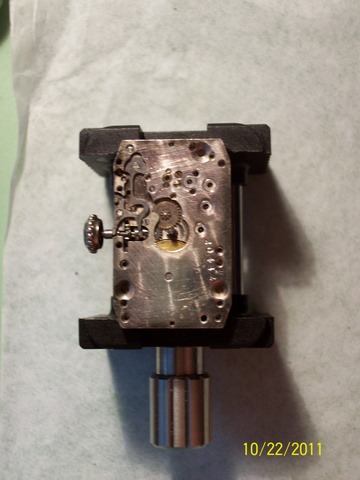

Mark G. Reitz
Note the stem set lever,I was able to remove the dial since screws were on the hand side

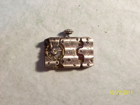

Mark G. Reitz
the 484 movement after clean and oiling

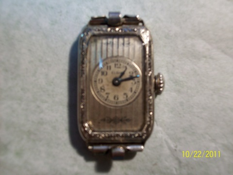

October 22, 2011, 21:05
Mark G. Reitz
A good view of the watch,Thanks Ed for the site help I am a newbie at this so the pics aren't the best.Turns out the set lever screw had to be turned into the movement to release the stem unlike the newer movements I have worked on where the set screw is turned counter clockwise.It is running great and keeping good time for a 1927 elgin in a 14 k wadsworth case
