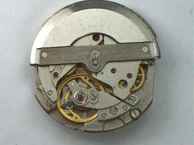

Around 1958 Elgin introduced a pair of notable advancements for their higher end watches, these were the Durabalance free-sprung balance, and the calibers 760 and 761, the only American made self-winding movements. These last great achievements of what was at one time the worlds largest watch company were unfortunately not enough to save the manufacturer. The Elgin National Watch Company was to last only five years after their introduction. These late Elgins offer an interesting challenge for collectors. With a few exceptions, they are not particularly rare, and the prices are generally low, but parts for watches of the late Elgin years are scarce indeed. So, why should a collector bother? I'll try to answer that.
Along with the 607 and 618, the Elgin 760 and 761 have the sad honor of being the only American made automatic movements. Even as they were being developed, other American companies were giving in to the Swiss dominance of the market. Hamilton adopted Swiss ebauches for its automatics; Waltham had tried that, but had already gone out of business in 1957, as Elgin audaciously pressed on.
The jewel count in these movements is given as 27 for the 761 and 30 for the 760. Pictured at right is a 761, with and without its rotor. A count of the visible jewels, and standard assumptions about those not visible, would account for only 21 - so where are the other 6? The answer is one of the most elegant innovations in the watch.

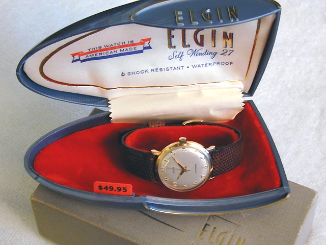

Interesting information Sheila,
The 27-Jewel mentioned in the article on Wayne's Elgin Collector's Site reminded me of the one our own John Flahive III recently contributed to our Chapter 185 Elgin Museum project...
LET'S HELP THE ELGIN HISTORICAL SOCIETY MUSEUM!
The new-old-stock watch John contributed provides a unique glimpse at how these were marketed.
27-Jewel contribution from John J. Flahive III collection...

Lindell,
What a wonderful picture! Pretty "Space Age" huh? Thank you.

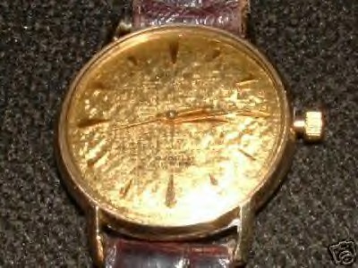

Another US automatic, currently on ebay ----

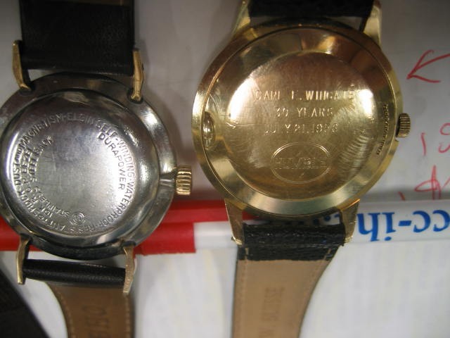

The "extra 6 jewels" Elgin used as self-winding Sprague type 1-way roller clutches. The "Micro eccentric roller jewels" are in both the 760 and 761 automatics.
Regarding working on these, I repaired a Gold "Humble Oil" Presentation 760 by using "donor parts" for one clutch that was broken. Working on this guy "Cured" me of wrist-watchmaking. But it keeps excellent time as do the other two 761's (which look a lot thinner becauuse they have the BWR RR Gr. Mvt.) I like to use as carry watches.

Beautiful dials. The "Durabalance" Elgins ALL were uniquely marked with the Upside-down lollipop type Circle with a vertical line coming out the top only. These are US-Made, and among the finest Horological technology ever devised for high accuracy efficiently manufactured wristwatches.

The thinner cased (and waterproofed) 761 type made for a noticeably thinner "look" when wearing.
