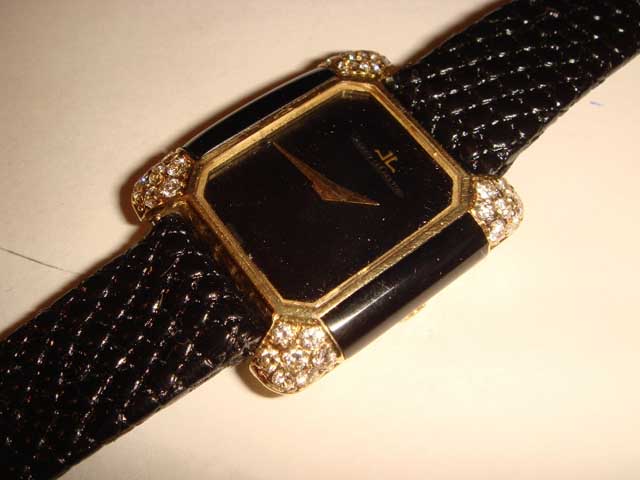

I HAVE A LADIES, JAEGER LECOULTRE... I NEED A CROWN AND STEM REPAIR, MUST BE A GOLD LECOUTRE CROWN, ANYONE HERE WHO CAN DO THIS?

Whaddya got-a LeC. 460 or 490 or.......?? What type of case? I have lots of ladies LeC. dress and spring dust-resist crowns. Could you post a photo of watch? I can at least supply the parts. This isn't hard job, I recommend learning how if you are into dealing in watches

December 06, 2009, 22:41
Andy Schwartz
pics

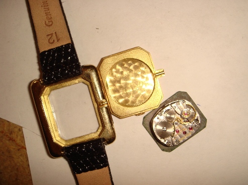

December 06, 2009, 22:42
Andy Schwartz
cal 846

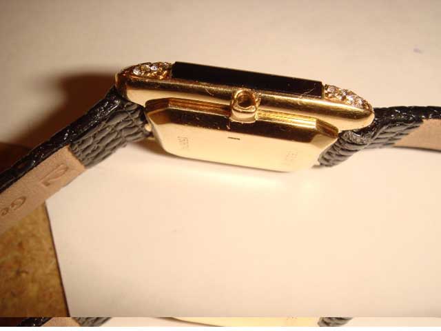

Andy Schwartz
last
December 10, 2009, 20:05
William Thomas
Unfortunately this model is too recent for parts to be available, as LeCoultre is one of those Swiss brands that withholds parts except to their own service centers. An older caliber 840 may be a base caliber for this one and its stem possibly interchangeable but but I have none of these left. Sorry I can't help you on this one.
